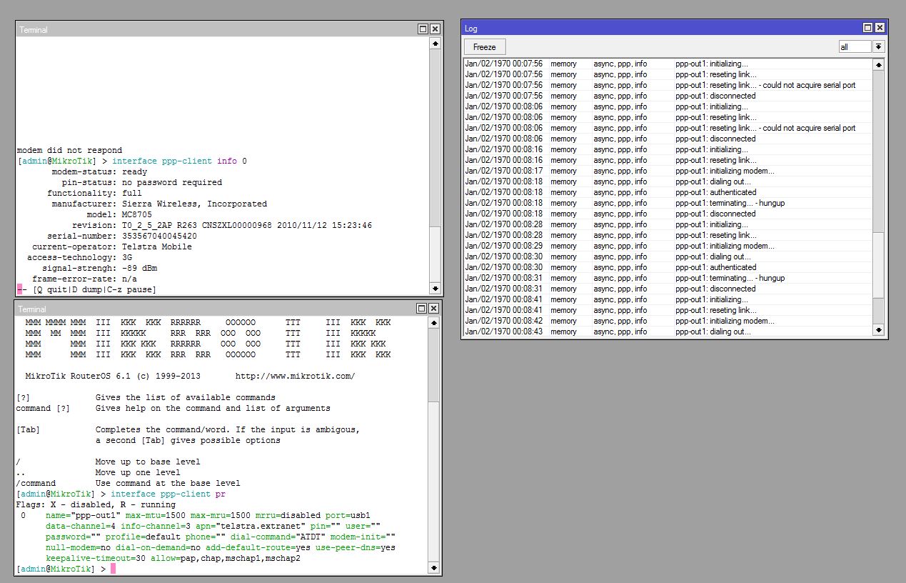

No I already have tried Dial-on demand=No option but it doesn’t work.
Please see in attached snapshot all settings on RB912. At the moment,3G network connection is down and it requires power cycle the router to get connection.
I also power-reset the USB. In logs, the entries “couldn’t acquire serial port” refer to USB power reset for 20 seconds. long power-reset durations also doesn’t solve the problem
