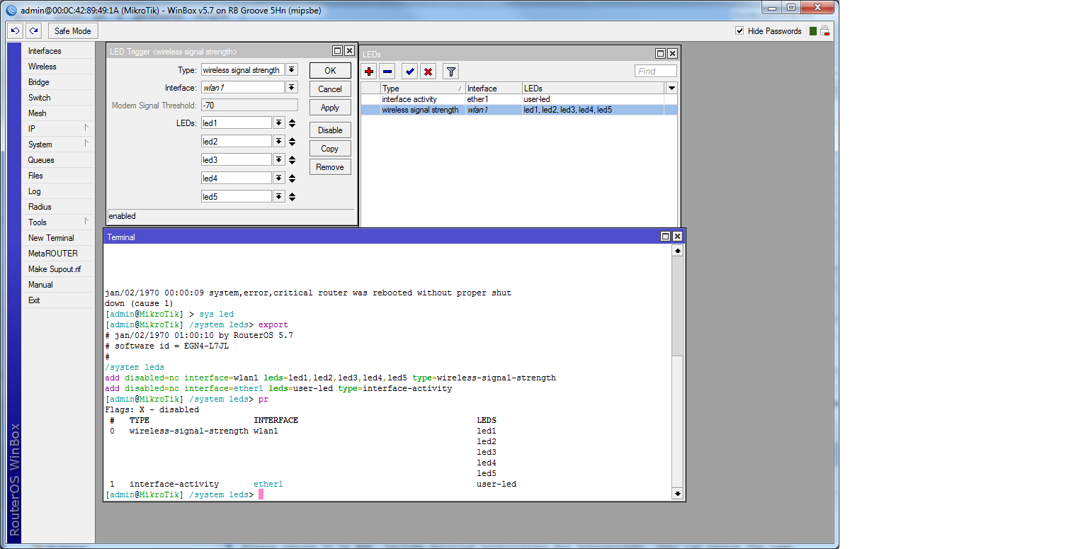

Signal strenght setting of LED lights (Groove)
In Groove (and probably other units) we can attach the LED lights to certain functionalities, like signal strenghts.
But there seems to be a non-editable start signal strength. It shows in winbox, but in terminal it doesn’t even show!
Anyway, can the ‘start’ value be set anywhere? And how is ROS deciding on this start value? I have seen values of -40, -55 and this one shows -70!
“modem” threshold is for 3G modem. It’s disabled because groove doesn’t have one, and has no USB.
