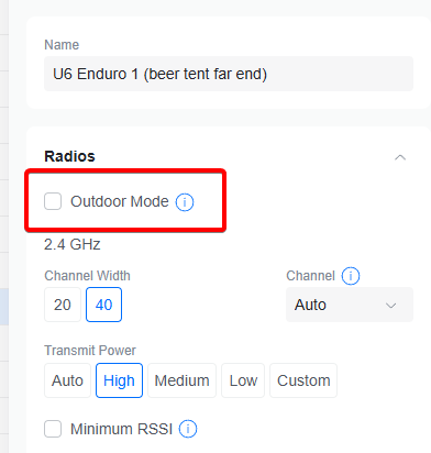

I happened to notice this checkbox on Unifi yesterday. I wonder how many people tick the box if they're supposed to? This AP is actually outdoors but I've forgotten to check it! This checkbox disappeared from RouterOS a while back. Is it now inferred by the fact the device is designed for outdoors and from the country configuration table? What happens if you want to use an outdoor device indoors? Also, I don't recall any questions about country and therefore Tx power limits. Is this possibly why signal strength is such a hot potato on Mikrotik? Do Unifi play fair and limit (say) UK power?
