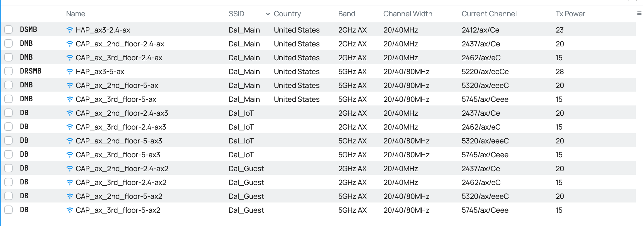

Problem Description:
Each time I add a new access point (AP) to CAPsMAN, its signal strength seems to be progressively weaker than the last one. Here’s what I observe:
• The first AP (hAP ax3) works fine with strong signal.
• When I add the second AP (cAP ax1), the signal on that one seems weaker compared to hAP ax3.
• After adding the third AP (cAP ax2), its signal is even weaker.

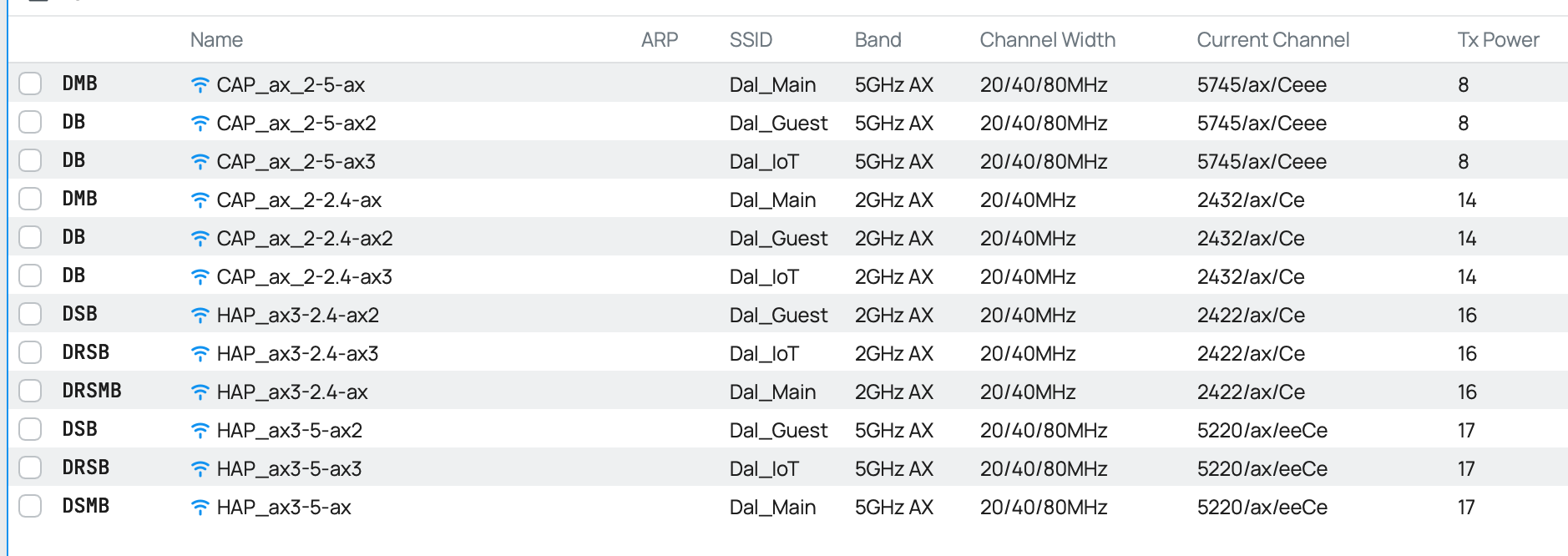

This issue affects both 2.4 GHz and 5 GHz bands. All APs are set up using CAPsMAN with centralized configuration for SSIDs, security profiles, and datapaths (guest, IoT, main networks).

I tried to select different countries and max tx power, but it didn’t give a result. T

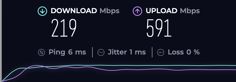

At a distance of 2 meters without obstacles, the signal strength is only -68 dB. I can see my neighbor’s wifi signal more strongly (-48 dB).
It’s also interesting that the download speed is lower than the upload speed.

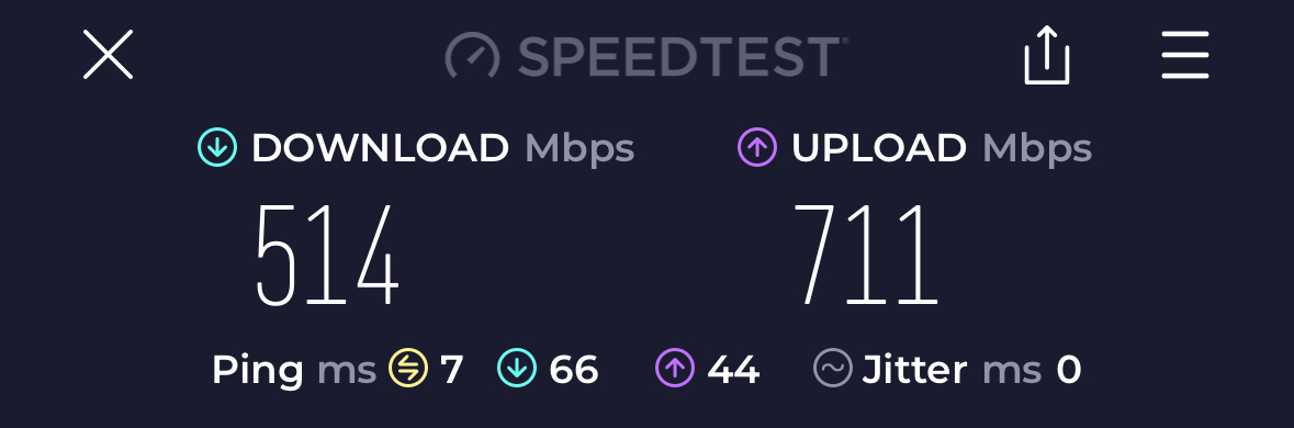

And this is result when I put my phone on cAP ax

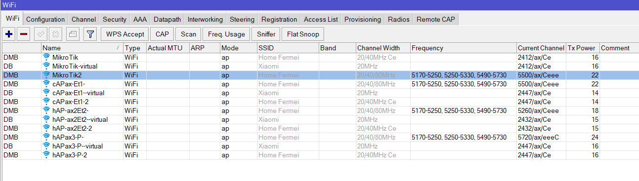

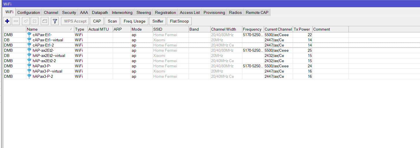

When you tested the two APs, were they in the same room or on different floors?
I have a similar setup with 3 equipment on three floors.
I also turned on an AP on the first floor near the hAP axis and I noticed that, if both are turned on, the Tx changes, especially for 5Ghz.
There were also bigger differences, but I did not record them.
You could try to reset cAP ax and reconfigure it.

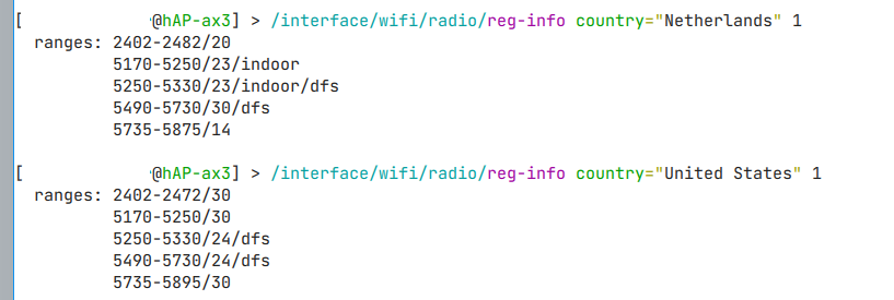

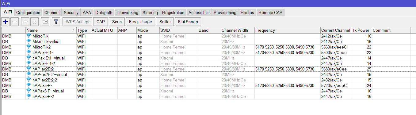

TX power is just one part of the equation, you have to add antenna gain and then there are country regulations… So, if your country regulation dictates max 20 dbi transmit power you have to deduct antenna gain (in case of cAP ax 6 dbi), so you have 20 - 6 = 14. And thats exactly what you have.
When you compare used channels with country regulations it’s all in line. Mikrotik must obey country regulations and they tell you that you have to obey them too. But question is, what measures goverments have to enforce those from milions of users with 0 knowledge of networking and regulations.
Why do you have bands for AC and N when you have only AX devices?
You have create-dynamic-enabled in provisioning so you can not change settings manully. You can use create-enabled and then you will be able to set channels manually. (it’s done on CAPsMAN side)
As @neki already hinted: Tx power is not constant over devices and channels.
If you look at device product pages (cAP ax and hAP ax3), section “Wireless specifications”, it becomes obvious that hAP ax3 has, in principle, higher Tx power available. When, e.g. talking about 2.4GHz ax, it’s 22dBm v.s. 17 dBm. Some of the difference is “taken away” due to country regulations … ETSI countries limit EIRP on 2.4GHz to 20dBm, where cAP ax again “suffers” due to higher antenna gain (6dBi v.s. 3.3dBi … the later translates into 4dBi due to integer settings). And this difference of 2dBi is what you actually see in your status screens. If you’d reside in country with higher EIRP limits (e.g. US), then the difference would be bigger (the chipset Tx power capability would be the limiting factor).
The Tx power difference is similar (but to lesser extent) in 5GHz band (antenna gain of both devices is same, 5.5dBi; chipset Tx power of cAP ax is between 3dBm and 5dBm lower than hAP ax3). Bigger difference on 5GHz band can come due to different Tx power allowed for different channels.
Hi folks.
Thanks all for the help. I resolved the problem:
  1. I choose USA for every config
  2. Set up max tx power for each floor (ground - 30, 1st - 20, 2nd - 15)
  3. Spliit channels
    so now configuration is the next:
/interface wifi channel
add band=2ghz-ax frequency=2412 name=ch-2.4-ax-1st width=20/40mhz
add band=2ghz-ax frequency=2437 name=ch-2.4-ax-2nd width=20/40mhz
add band=2ghz-ax frequency=2462 name=ch-2.4-ax-3rd width=20/40mhz
add band=5ghz-ax disabled=no frequency=5180,5200,5220,5240 name=ch-5-ax-1st skip-dfs-channels=all width=20/40/80mhz
add band=5ghz-ax disabled=no frequency=5260,5280,5300,5320 name=ch-5-ax-2nd width=20/40/80mhz
add band=5ghz-ax disabled=no frequency=5745,5765,5785,5805 name=ch-5-ax-3rd skip-dfs-channels=all width=20/40/80mhz
add band=5ghz-ac disabled=no frequency=5180,5200,5220,5240 name=ch-5-ac-1st skip-dfs-channels=all width=20/40/80mhz

That’s so wrong and the config looks like total mess.
You came here because you wanted more transmit power, then we explained to you that there are some country regulations and after that you changed country to get more power and after that you started to limit the power by yourself? Does it make any sense?
Question is, do you want help?
As the entire bandwidth on the 2.4GHz radio is 40 MHz (I will leave channel 12/13 out), you should understand that by using 20/40MHz bandwith you obviously have interference.
The same is for using only non DFS channels on the 5GHz radio. There is not enough bandwidth on the 5GHz radio left to prevent interference. And that is only from your network, while your neighbours have wireless networks as well.
What I have done is set the reslect interval to have the radios periodically scan for better frequencies. And set the bandwidth on the 2.4GHz to 20 MHz (obviously) and the 5GHz radio to 40MHz. Rocksolid wifi with roaming clients. Have lots of experience with other brands and always had best stability with these settings.
But the real problems is assuming higher transmit power is better. Well…it is not. What you should focus on is the connection rate per client. If that is good, well…there is no problem.
