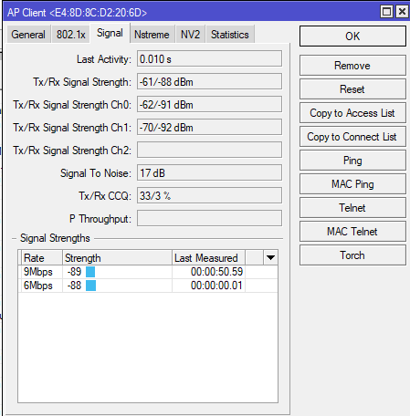

Signals BAD after latest upgrade
Any ide why my P2P signals went from 45/50 to 62/92?

911G-5HPacD - Jirous dishes - 12 Km , 802.11, literally nothing was changed just did upgrade from 6.43.14 to latest OS and this happened , wanted to downgrade but cant even log into the far link, it is P2P link , same if i change for NV2

It’s possible that the antenna gain has changed on the radio to contry regulations reducing the power causing the signal to change. Did you upgrade both radios or just one?
Choose superchannel and no country for maximum power.
