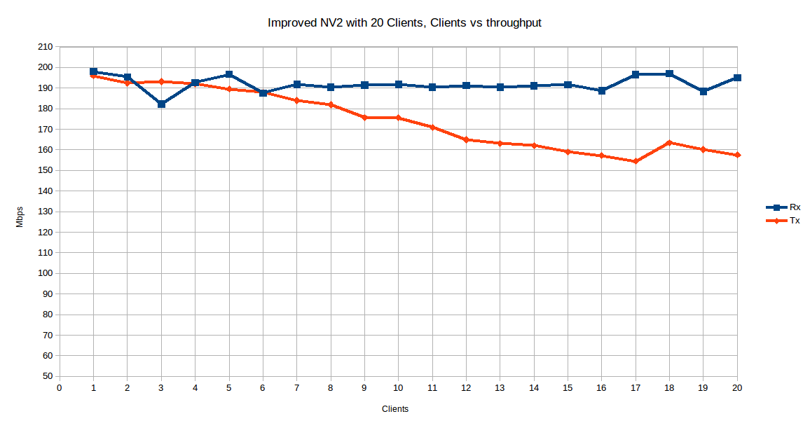

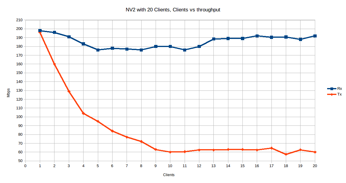

In the pictures below you can see the differences without and with the Nv2 improvements. TX and RX tests are done separately. TX is total/combined download speed from the AP to the clients.

this is the test with 802.11ac or 802.11n radios?
Could you describe in more details signal levels and hardware used?

In the setup we had a R11e-5HnD as AP and Clients was SXTsq Lite5
In BAND - N? Channel width? 40Mhz? TDMA = 2ms or AUTO? More info about config please…

band=5ghz-a/n channel-width=20/40mhz-Ce un TDMA - 2m
What was the distance between the AP and SXTs?
In what universe can you actually reach 200Mbit in ptmp? We have a problem getting 200Mbit even in ptp. (N, 20/40-Ce)
200Mbit in TCP.
Of course, with the growing number of clients, the chart is real.
I believe it is udp
We had a 6km PtP link doing 200mbit TCP with 802.11n using Jirous 24dBi dishes. Doing it on PTMP though, that would be impressive!
