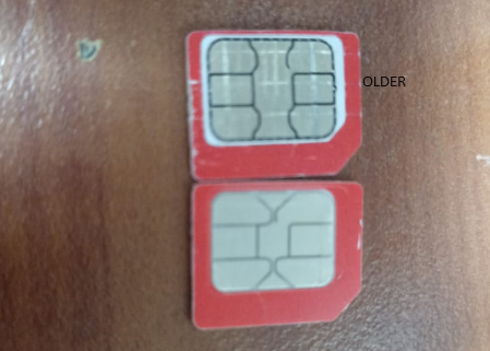

I know the SIM cards are good because they do work in the Raspberry Pi. I can also see that the contact marks are being made from the first time I inserted the new SIM cards into the wAP devices (the little scratch marks from the contact points on the face of the SIM card). I get to looking at the new SIM cards and think maybe they are not as flat as they should be and so not all the contacts are being made so I’ve tied to make the SIM cards thicker with tape and a combo of tape/paper but still SIM card is not detected by the wAP.
So now my only thoughts are that these new SIM cards that I got from my wireless provider are 5G capable - my rep says they are backwards compatible and this has been proven to my by the Raspberry Pi 4G modem working just fine with the SIM card. But I’m very worried that for whatever reason the Mikrotik modem isn’t compatible with it and so all of these new SIM cards that I have and need to get deployed in the next month will not work with the wAP.

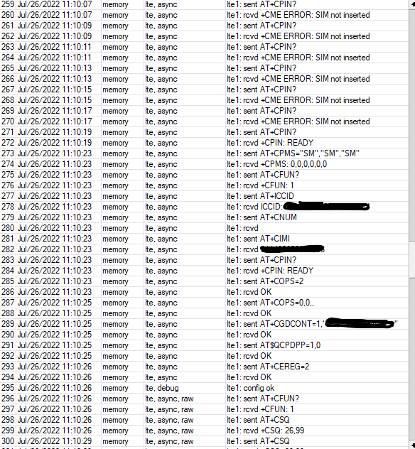

Edit: I attached a log. The SIM not inserted is the while the new SIM is inserted and then as soon as the old SIM is inserted you can see that everything works as expected. But the New SIM seems to just not respond to the CPIN command…

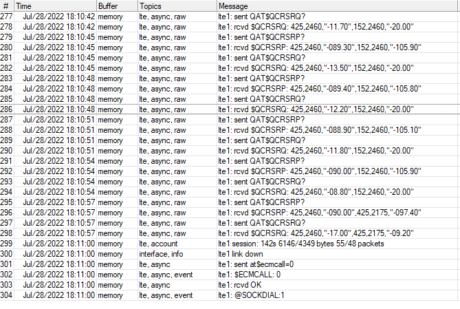

I’ve tried this twice now. Seems the modem goes down and then there’s no possible way to get the update. Any suggestions? Should I downgrade and update the firmware first?
