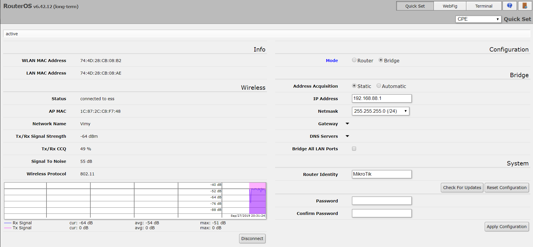

Hi.
I’m a new Mikrotik user. Like robshep952, I’m trying to make my hAP mini act as a bridge between an ethernet device that has no wireless card (a NAS) and my home wifi. I successfully connected to home wifi (Vimy) but, when I plug my computer in the Ethernet 1 port of the hAP mini and try to load Google, I get the message that no Internet is available, and to check my DNS.
Would one of you have a solution ? :slight_smile:
Thanks in advance!
hmarceau,
You need to set your hAP up as a CPE. This cannot be completed from the Quick Set page. You should have Winbox.exe to complete your setup. If you can use Winbox then the following instructions should get you a wireless connection to your home network to any device plugged into an ethernet port on the hAP.
  1. Go to System->Reset Configuration, tick “Do Not Backup” and “No Default Configuration” then click Reset Configuration
  2. When the router has rebooted access the Quick Set page using the MAC address of the hAP
  3. Under “Configuration” choose “Bridge”
  4. Under Bridge set a static IP in your home wifi subnet along with the appropriate netmask, gateway and DNS. Select “Bridge All LAN Ports”. Make sure it is not an IP that the home router would assign automatically.
  5. Click “Apply Configuration”
  6. Access the configuration pages using the MAC address
  7. Go to “Interfaces->Interface” tab & enable wlan1
  8. Go to Interfaces->Interface List" and change wlan1 to LAN
  9. Go to System->Reboot and Reboot the router
  10. Access the router and go to the Quick Set page
  11. Click the Disconnect button in the bottom middle of the page and then select your home AP from the Scan List and connect.
w32pamela,
Thanks in advance for your patience! Several small things…
May I use the hold-reset on power technique instead? When I try your way, I can’t connect to the hAP anymore…
Did you mean IP address?
How do I know which is the appropriate netmask, gateway and DNS ? My router IP is 192.168.1.1 and provides IP in the range of 192.168.1.xxx.
How? In Winbox, I only see a promp for IP address.
You must use winbox to make the changes in the instructions. Read https://wiki.mikrotik.com/wiki/Manual:Winbox for information about winbox.
1.When you use the steps in the instructions you are taking all default configurations off the router. There will be no IP address. Winbox will show the ip as 0.0.0.0. You must use the MAC address shown by winbox to reconnect to the router. The instructions will not work if the router has the default configuration.
2. See above.
4. Your IP range will have a start and an end address. Your home router will assign IP’s in this range. If your router is assigning IP’s from 2 through 254 then modify the address pool to assign 10 through 254 and set your router to a static ip of 192.168.1.2, netmask of 255.255.255.0, Gateway=192.168.1.1 and DNS=192.168.1.1. If your home network is using some other Gateway and DNS then substitute those.
6. Winbox should find your hAP mini and display a line of information about the router in the lower half of the window. The first column has the MAC and the 2nd has the IP. Click on the MAC address and it will appear in the Connect To: box at the top of the window. Then click the “Connect” button. Your computer ethernet must be connected to one of the LAN ports on the hAP mini. Be sure to select the Neighbors tab then hit Refresh to see the information about your router.
