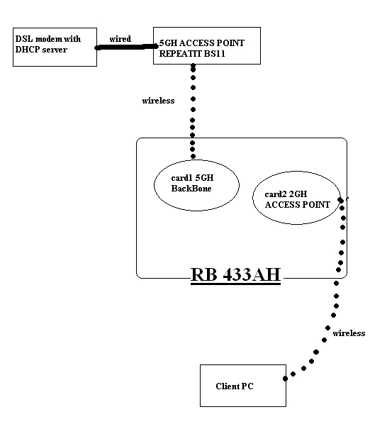

This supposed to be a very simple setup, but.....
I have a 433AH with two radio cards:
one to connect wireless to my Backbone, and
one to work as an AP for clients
Here is my setup:
Connections are ok, the wlan1, wlan2 are bridged
with a DHCP client running on that bridge.
The bridge interface gets a valid ip, dynamic routes are created (ok),
the client computer also gets a valid ip, gateway, BUT client cannot
access anything but the 433AH. Not even the modem.
From inside 433AH using ping I can access everything but the
AP clients are totally blind.
This has to be a routing isssue, please help

On the “backbone” you will either need to use WDS or you could use station-bridge if it is connecting to another MikroTik.
Ok, WDS but how?
The backbone AP is not Mikrotik (Repeatit BS11) and there are no WDS params to configure for the AP.
The only WDS params I see are in the Mikrotik station. And I’m not sure how to config.
The only solution I’ve found till now is to use station-pseudobridge mode but I really would like
to have a real transparent bridge. Is this so difficult? Is it possible?
Are the DHCP supplied IP’s coming from your DSL modem?
How is the RepeatIT BS11 connected IP wise?
Is there maybe some NAT’ing problem?
