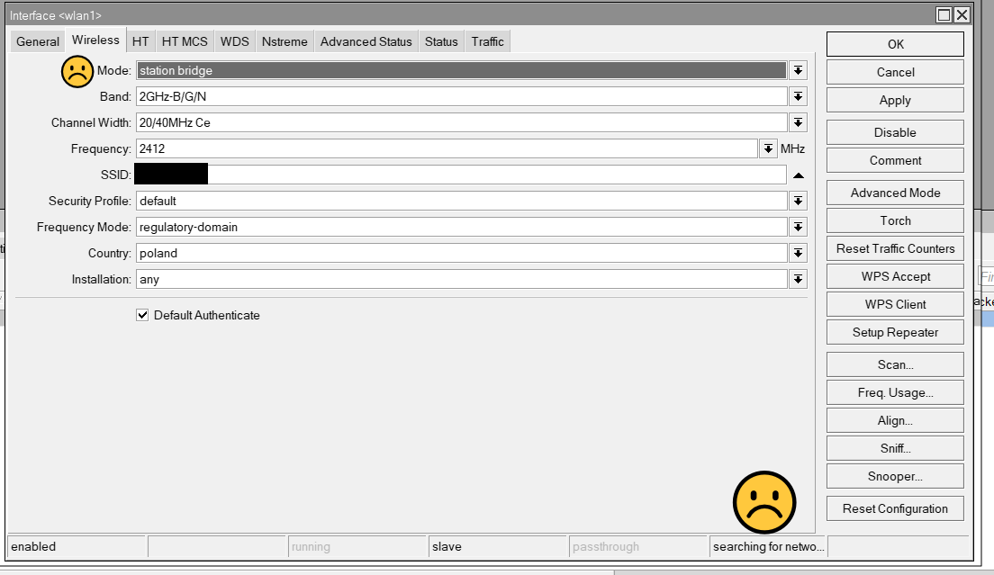

Unfortunately after setting wireless mode to “station bridge” I lost access to it - it’s no longer visible for WinBox.

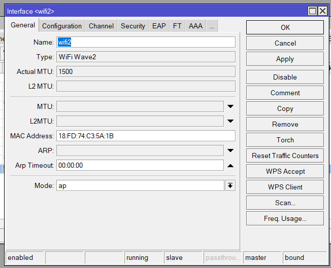

Now is all OK, but I do not know if the hAPax2 work on ap-bridge mode because wifiwave2 do not support 4MAC mode.
Wireless protocol in any of station modes can be set to all 3 as it is now … actual mode will be mandated by AP anyway.
I’d change another thing:
/interface wireless
set [ find default-name=wlan1 ] installation=any
The above setting affects the list of allowed frequencies. Again let AP to lead the way.
(wifiwave2 is not only 802.11???)
installation=any
Nice catch!
Ah, indeed @rextended is right about 4-address mode with wifiwave2 driver. OP might have to revert to “station-pseudobridge” wireless mode instead. That comes with its share of problems though. Not running DHCP client on mAP will make it slightly better (you can always use MAC connection to do the management).

Formerly all is set as expected, except “B” mode and “802.11” only wroted before.
Now the problem is try what wifi mode work with wifiwave2 driver.
Try station-bridge and station-pseudobridge, if fail on both…

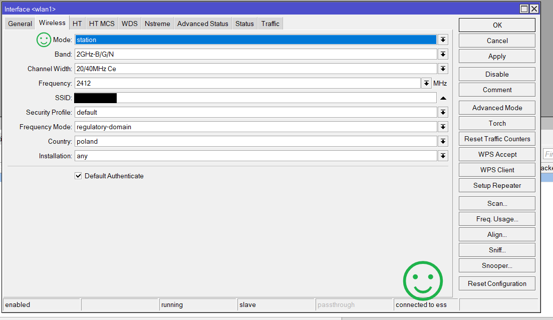

Wireless itf used for connecting to other AP should be in station.
If any virtual interface is going to be defined on that same mAP Lite (for whatever reason), it should be in bridge.
That’s how it works on my device connected to a hAP AC3 with wiwifave2.
But … AC2 ? That doesn’t run wifiwave2.
You mean AX2 ?
I don’t have any ax2 device to do some test,
but probably creating an EoIP tunnel between lite wlan1 in station mode and inside the ax2 in ap mode, can it pass the traffic like an ethernet cable?
No mind, the instructions are for the hAP lite which has less memory than my ac2.
Once you changed AP mode to station, connect your PC using ethernet to mAP Lite.
Scan the wireless SSIDs and connect to the one you want.
Ah wait … mine is set with a DHCP server (road warrior device, sets up VPN as well to home).
station-bridge it is then.

Main home router (HAP ax^2) is using AP mode:
When I unplugged the ethernet cable from mAP lite, mAP lite is not visible from Winbox anymore.
AX2 needs to be in AP mode (my AC3 running WW2 is also in AP)
mAP Lite needs to be in station-bridge mode. Then scan for network on wireless interface of mAP, select SSID of ax2 and connect.
Make sure your security settings are ok on map and specified for that wireless interface.
It won’t connect with station bridge setting:
How about station-pseudobridge mode?
