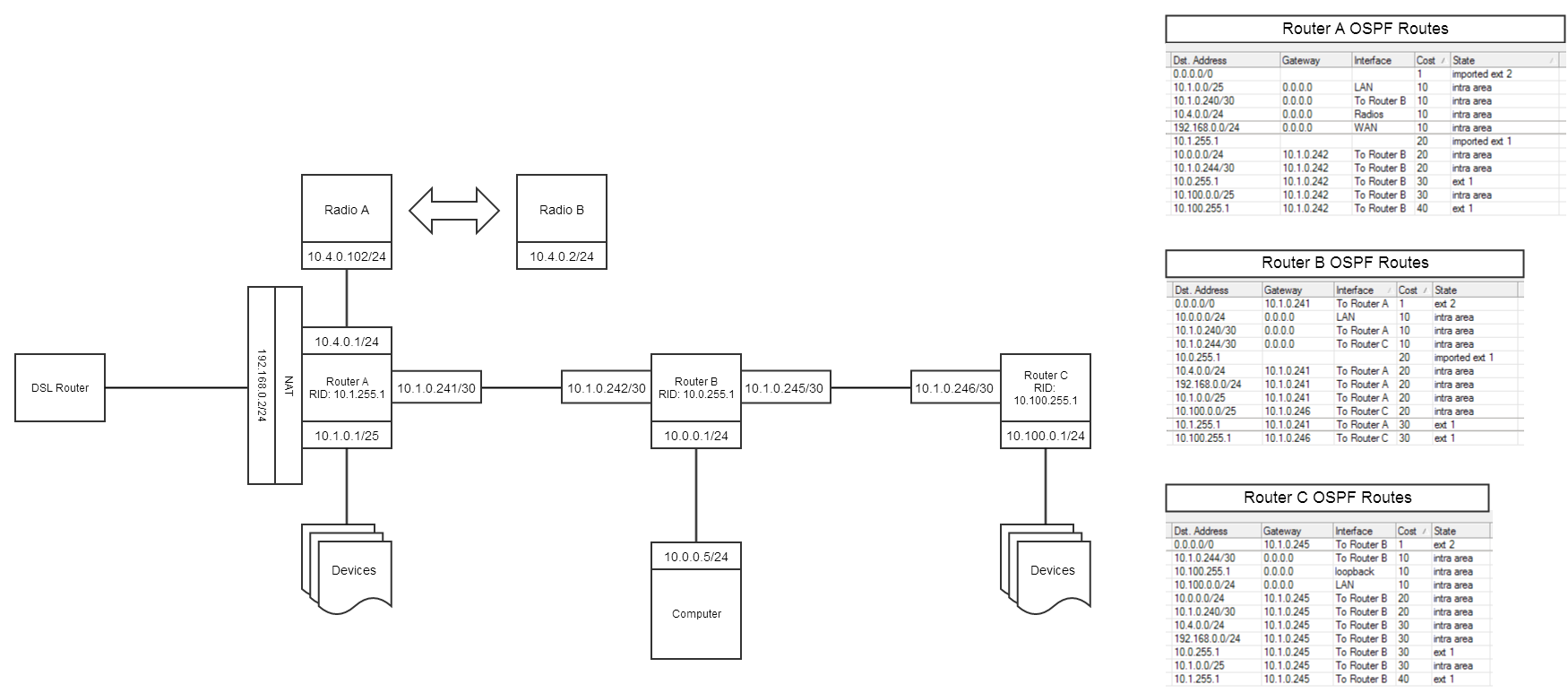

Alright, so I have 3 mikrotiks (2xRB2011 and 1x750GL) connected “in series” with one attached to my DSL router. I have an AirFiber < – > AirFiber link with one end on a router.
Setup (with OSPF routes listed): (http://goo.gl/M3BGMF)
Long story short, I’m trying to setup the 3 routers via OSPF. So far, that works! They share eachother’s routes and all routers have access to the internet via my DSL router.
Only problem is, I can’t ping between subnets on the network. EG: 10.0.0.5 can’t ping 10.4.0.102, etc. From what I can gather, the ICMP packet traversing the network to the appropriate router, and (I think) even to the device, but it never returns.
  • In this setup, Router A can ping 10.4.0.102, 10.0.0.1, and 10.100.0.1. Router B can’t ping 10.4.0.102, but can ping the others (10.1.0.1 and 10.100.0.1).
    The only NAT I have is between Router A and my DSL modem (set to masquerade).
    No interfaces (other than “LAN” on a few routers) are bridged.
    I have a few firewall rules that basically open up everything (for testing purposes… doesn’t seem to matter though as it is open by default).
Any suggestions? I’m pulling my hair out… :cry:
Please show route table on RadioA.
And check default gateway on RadioA. Maybe, RadioA not known how access to RouterB.
Sorry for bad english.
Hey! So I figured it out. Turns out the gateway of the offending radio wasn’t set properly. I feel like an idiot. :stuck_out_tongue:
Thanks Resetsa!
