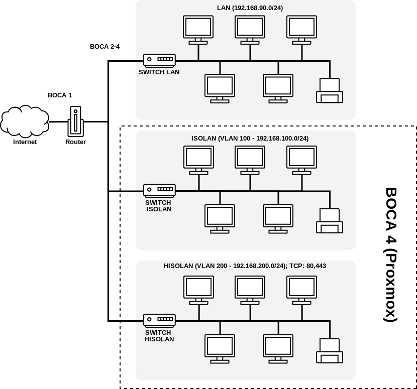

Dear all,
since the “new” changes to VLAN configuration I am blocked trying to configure a personal lab with Mikrotik and Proxmox. My goal is to achieve the scenario shown in this picture:
NOTE: BOCA means port.
The problem here is that Proxmox is connected with only 1 interface on port 4, therefore I need to allow tagged (ISOLAN + HISOLAN) and untagged (LAN) traffic. How can I get this configuration ?

Xavi your written description does not match your diagram.
You show ports 2,3,4 connecting to 3 switches.
Switch 2 feeds to your private LAN
Switch 3 feeds ISOLAN (vlan100)
Switch 4 feeds HISOLAN (vlan200)
Okay I understand in reality you only have one input for all of BOCA4
So port 4 on the router feeds (one or two managed switches) and two VLANS.
I still dont see why you need untagged on port four, your diagram does not show any private LAN on the BOCA 4???

Hi, sorry, as you stated, what I am looking for is not completely shown in the diagram. As a context, this “project” is for a vocational school trying to build a very simple configuration in order to allow them to play with unsafe software in two levels (**):
  • ISOLAN (vlan 100): must be fully isolated, no communication from ISOLAN can be made outside (Internet and LAN). Even though, traffic from LAN can achieve any VM in ISOLAN. Traffic between VMs in the same VLAN must be possible as well.
  • HISOLAN (vlan 200): It’s the same scenario than ISOLAN but allowing only DNS, HTTP, HTTPS queries to Internet.
In the simplest scenario I want:
  • ether1: is connected to Internet.
  • ether2-ether4: are LAN connections. But, ether4 is directly connected to a Proxmox.
Afterwards, the Mikrotik firewall will apply the specifications defined before (**).

add name=pool-HISOLAN-200 ranges=192.168.200.100-192.168.200.200
add address-pool=pool-LAN disabled=no interface=bridge-LAN lease-time=1w name=\
    dhcp-server-LAN
add address-pool=pool-ISOLAN-100 disabled=no interface=vlan-bridge-LAN-ISOLAN-100 \
    lease-time=1w name=dhcp-server-ISOLAN
add address-pool=pool-HISOLAN-200 disabled=no interface=vlan-bridge-LAN-HISOLAN-200 \
    lease-time=1w name=dhcp-server-HISOLAN
add bridge=bridge-LAN interface=ether2
add bridge=bridge-LAN interface=ether3
add bridge=bridge-LAN interface=ether4
add interface=ether1 list=WAN
add interface=bridge-LAN list=LAN
add interface=vlan-bridge-LAN-ISOLAN-100 list=VLAN-MEMBERS
add interface=vlan-bridge-LAN-HISOLAN-200 list=VLAN-MEMBERS
add address=192.168.90.1/24 interface=bridge-LAN network=192.168.90.0
add address=192.168.200.1/24 interface=vlan-bridge-LAN-HISOLAN-200 network=192.168.200.0
add address=192.168.100.1/24 interface=vlan-bridge-LAN-ISOLAN-100 network=192.168.100.0
/ip dhcp-client
add dhcp-options=hostname,clientid disabled=no interface=ether1
add address=192.168.90.0/24 dns-server=8.8.8.8 domain=lomio.lan gateway=\
    192.168.90.1 netmask=24
add address=192.168.100.0/24 dns-server=8.8.8.8 domain=lomio.isolan gateway=\
    192.168.100.1 netmask=24
add address=192.168.200.0/24 dns-server=8.8.8.8 domain=lomio.hisolan gateway=\
    192.168.200.1 netmask=24

Please actually post your config not the replication of what I suggested its very confusing…
I need to see a clean latest config.

/export hide-sensitive file=yourlatestconfig
Oks, I didn’t know about hide-sensitive, really useful!
yourlatestconfig.rsc (3.46 KB)
  1. Missing /interface bridge vlan rules…
add bridge=bridge-LAN tagged=bridge-LAN,ether4 vlan-ids=100,200
(assuming only ether4 requires to be trunked with vlans at the moment)

Damn, Still does not work.
I guessed [1] it required also to activate the /interface bridge vlan-filtering but neither in this operation mode worked.
I am absolutely lost.
Were you able to run this use case ?
Do you want me to sniff or debug in part of it ?

Post your latest config…
Ops, I forgot it, sorry.
yourlatestconfig-with-bridge-vlan-rule.rsc (3.55 KB)
While I am looking at this you should update your OS to 6.44!
Is the first switch on ether2 a managed switch??
ok, updated but still does not work.
On ether2, ether3 there is nothing connected.
  • ether1: 172.19.20.0/24 which provides internet
  • ether4: proxmox
Regards,
Xavi
May be it can help: find attached a capture of the wireshark using Packet Sniffer from the interface “vlan-bridge-LAN-ISOLAN-100” and the current config.
current-config.rsc (4.17 KB)
I dont see any rule for your LAN to WAN (assuming no vlan to wan required)
I dont see any rule for admin access to vlans either.
the rest looks okay argggg??
Also I am assuming that the managed switch between the devices and the router is marking the packets!!
(ie its ports to the devices are access ports).
