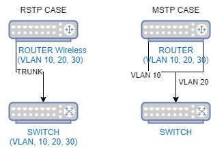

Just as confirmation, is this example (sorry not very precise) correct?
I do not understand the example. You cannot have a Y-shaped cable with Ethernet. If you connect two bridges using two trunk links:
  • with RSTP, all VLANs will use only one of the links and the other one will be blocked
  • with MSTP, you can have one group of VLANs prefer one of the links and the other group prefer the other link
In both cases, all VLANs must be permitted on both links, as if one of the links fails, all the VLANs will use the remaining one.
