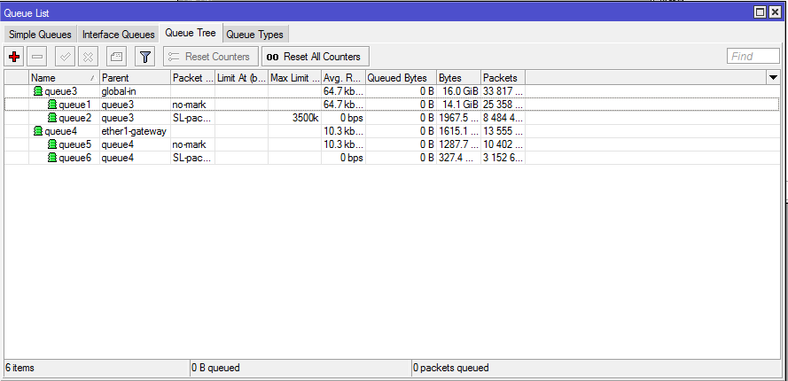

What you want to say with this screenshot, where’s the priority realization here?
And yes, current prioritization implementation in ROS isn’t working as expected or do not working completely - it’s clearly a ROS problem. I don’t know how everyone on this forum make statements that “it works fine”, that not true, it (prioritization) works like crap…

RouterOS (well, HTB) doesn’t have the concept of strict priority queuing. There simply is no way to say “packets in this queue always go on the wire first”. That’s a restriction of the implementation. There’s nothing you can do about it. Your quoted request is impossible to do in RouterOS.
That said, you can somewhat prioritize packets, but there are caveats. You can find them here: http://wiki.mikrotik.com/wiki/Manual:HTB
Priority
We already know that limit-at (CIR) to all queues will be given out no matter what.
Priority is responsible for distribution of remaining parent queues traffic to child queues so that they are able to reach max-limit
Queue with higher priority will reach its max-limit before the queue with lower priority. 8 is the lowest priority, 1 is the highest.
Make a note that priority only works:
for leaf queues - priority in inner queue have no meaning.
if max-limit is specified (not 0)
You do not have limit-at defined in your queues (which governs the CIR every queue will get regardless), and you do not have max-limit defined. Priority works on the packets that are above the CIR, packets that would fall in a stream running between limit-at and max-limit. Therefore there’s nothing to prioritize in the configuration you posted.
