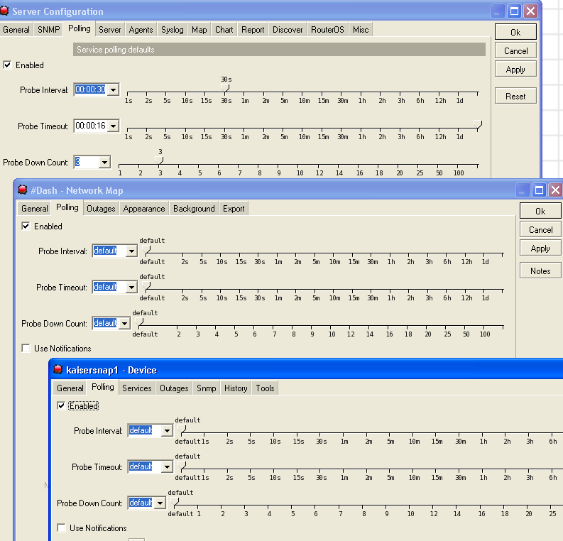

Where do I do to set how many good probe tests it takes to change state from down to up?
On the polling tab, check the settings of each area, one for global, one for each map and one for each device…
So, is probe down count value used for probe up count also?
That does not seem to be the case because up status sometimes takes minutes when system was only down 15 seconds or so (my settings are 10s, 5s, 1) and running v3.6 (v4 did not work well for me on W7 64bit)
