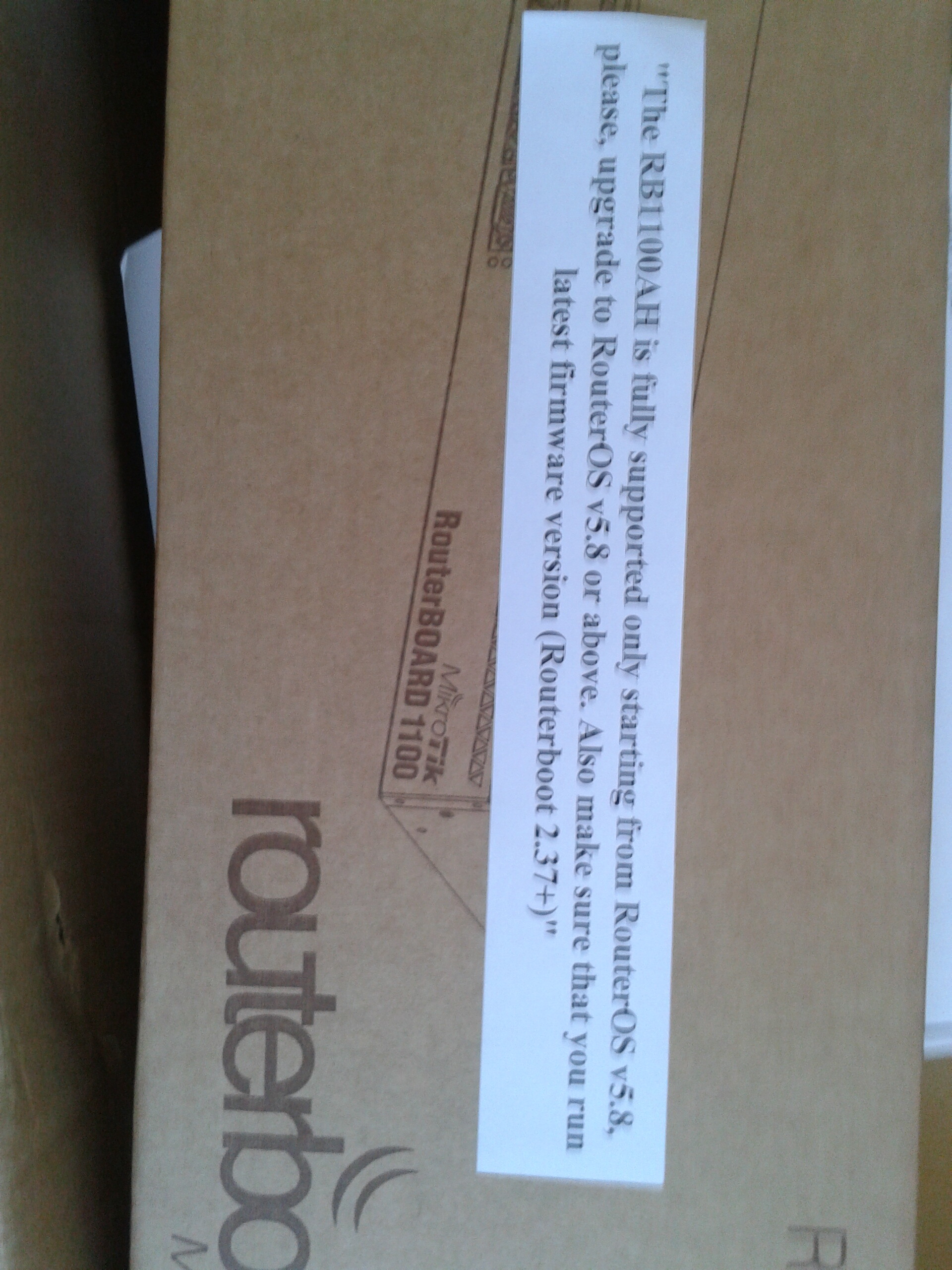

Thanks for your answer… I’ve seen that the last version of RouterOS for this appliance is: Version 5.18. But I’ve just unboxed the RB1100AH and I’ve got this message:
yes, v5.8 is an old version. v5.18 is the latest one.
