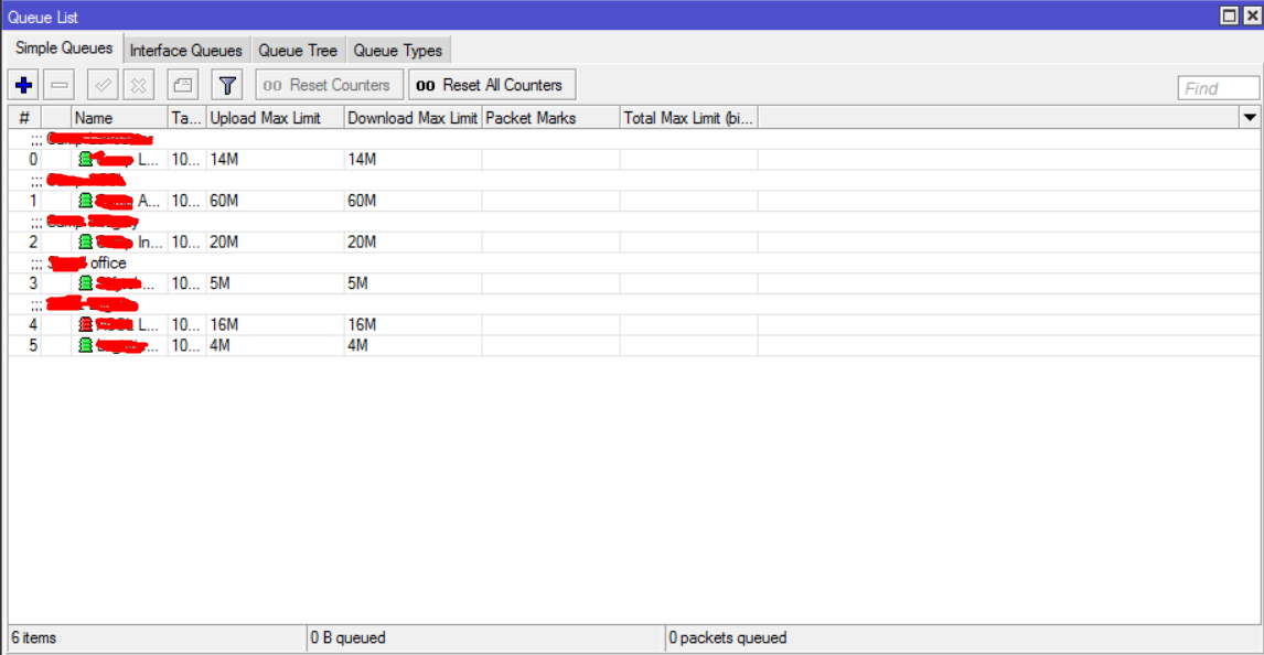

I have 2 customer one is assign bandwidth of 16/16 Mbps and second user is assign 60/60 Mbps using simple Queue

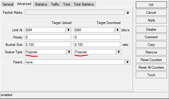

The problem though is on both the user i have packet loss alot, I am attaching ScreenShot, i change the queue type , ethernet, ethernet-Default i even create a special Queue type of red
but still i see packet loss, Please check the attached screen shot and let me know if any body can help
Thats the Queue type i ceate but still packet loss
  1. Why don’t you use PCQ queue types?
  2. What is the total bandwidth for the network?
  3. If we are talking about QoS, please show priorities for both simple queues.
I have Different Client and Based on their Requirement i assign Bandwidth using Simple Queue
Please check the Attached ScreenShot
