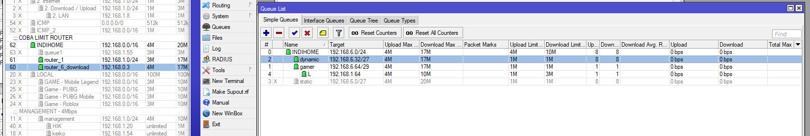

Simple Queue "Upload Max Limit" does not work
We have limit 20M download and 4M upload from our ISP.
Im trying to limit my router RB941-2nD 10M only, the setting is in RB750GR3.
Download limit so far is work as expected, but the upload still reach 4M instead 1M ?
Here is my diagram
Winbox connected to RB750GR3
Settings in winbox. (IP Firewall enabled in Bridge)
When testing from smartphone, download limit was successful, but the upload failed (red circle).
DHCP 192.168.6.x is in RB941-2nD IP, and as the gateway 192.168.6.1 for smartphones.
What am i doing wrong?
If you need any information, i will post them.
PS: im new to these Mikrotik hardware, i just bought the RB750GR3 back in Aug 2019. Almost everyday i’m playing around to get my goal.
Do you have fasttrack disablled in firewall?
And by the way, unrelated to this particular problem, I think it will make sense to:
  1. add your wan-interface as a Dst. to this queue group - I guess you want to limit only connections to outside world by these 3 queues?
  2. set your max limits the same for the child queues as the parent one and add limit-at values the same as you have max-limits now - why waste bandwidth if it is not used at the moment?!
change queue type from “default-small” to “ethernet-default”
Yes, fastrack is disabled in: Firewall → Filter Rules
And wow! number 1 solution works!
And even i dont need to do set “limit-at” same as max limit (stated in point 2).
Also thank you for points number 2, that 1M just for testing.
Thank you very much xvo.

Target of the parent must be changed to 192.168.1.0/24 and the algorithm used should be PCQ upload/download default.
After that it will work just perfect.!
Agree as well with xvo on 1 and 2
Agree about the parent’s target, but I don’t about choosing PCQ as a type for it:
  • if NAT is performed on .2 and .3 (or if you set PCQ Mask to /24) then it will substitute all 3 queues, and will work somehow. But, first, it covers only the scenario, where bandwidth needed to be distributed equally between routers, and second, in case of uneven load, some of the bandwidth will be lost. So parent + 2 child queues will work better.
  • If no NAT is performed, then it won’t be exactly what OP wanted.
However, keeping in mind that the total bandwidth is quite limited, setting child queue types to PCQ is actually a good idea.

Meanwhile, i have 1 more question,
This is the winbox view from RB941-2nD
See the “dynamic” with ip 192.168.6.32/27 i put “download limit at” 1M.
I set all smartphone for youtubers will be in that IP range.
Does it means every user in that IP range will get minimum 1M?
No, that’s for the whole range.
If you want each of them to have 1M you can either use PCQ queue type with higher max-limit, or have dynamic rules created for each client from DHCP server leases.
