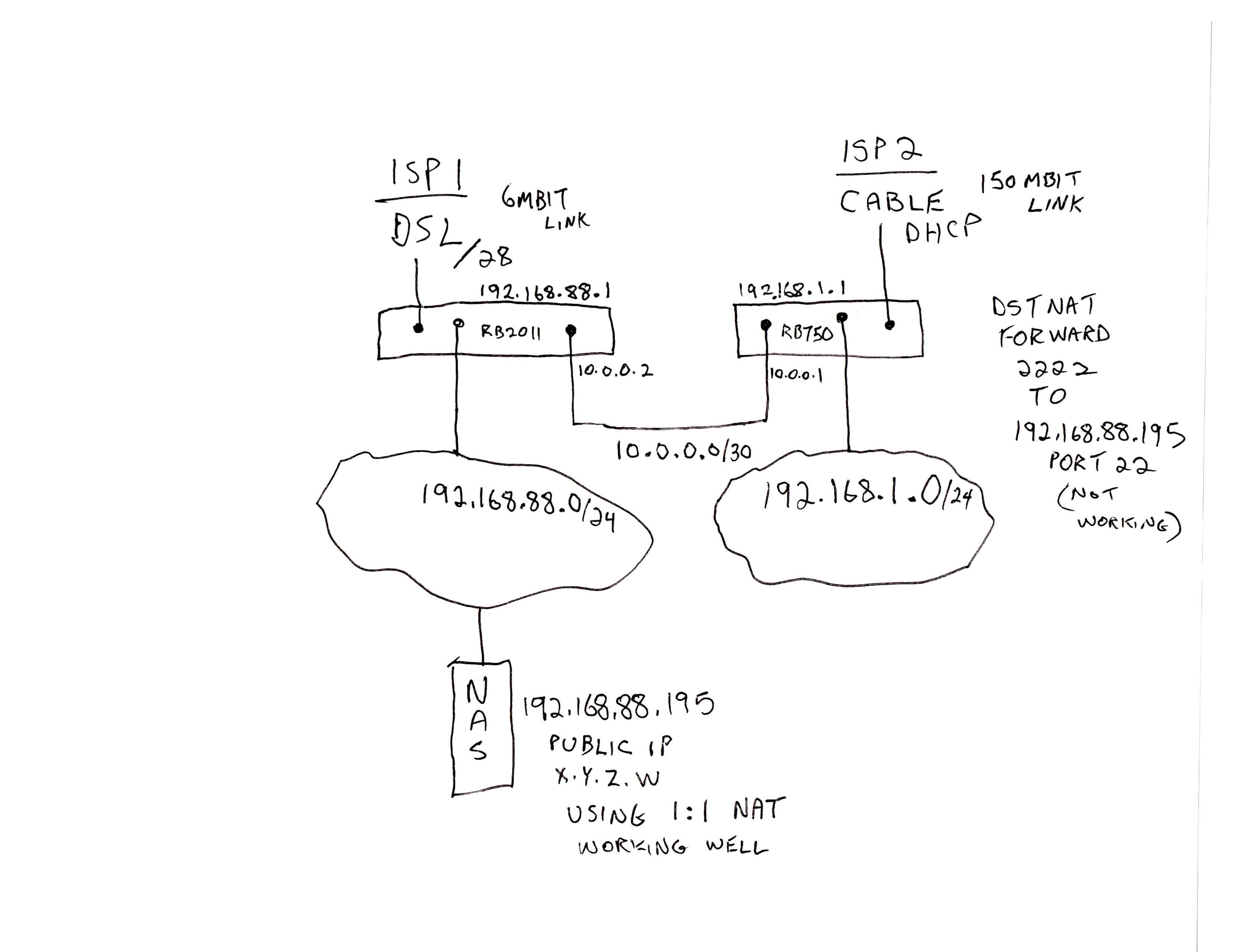

Could you perhaps make a diagram with IP addressing on it? It’s not clear to begin with to which address the 750GL ports forwards.

I’ll do up a quick diagram ASAP.
Here is a hand drawn diagram :slight_smile:
I am still thinking that connections/packet marks or routing marks are required but I don’t know how to implement them.
so thats your setup. You only need 1 router unless you are expecting a router to fail or have multiple locations. Using only 1 of the routers you can combine both internets the way you want and than do a general src and dst nat.

Is your LAN subnet 255.255.0.0?
There are no packets that are needed to be mark
I see your point in only needing one router. It is a bit of a legacy situation and so I never got around to getting the customer’s ISP links all on the RB2011.
Each router has an entry in the Firewall → AddressLists called “LAN” and is 192.168.0.0/16.
