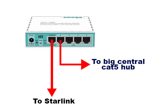

Hi all, very first time using MikroTik. Bought a Hex5 to block the ports of my IP cameras from the internet.
I have Starlink. The MicroTik POE/Wan port plugs into Starlink. Then I have a 16-port cat5 hub that plugs into the MicroTik’s first ethernet port.
I haven’t attempted to do any blocking or setup yet-- this is just a straight, out of the box plug in. I can’t see internet, and I can’t see the Starlink router at 192.168.100.1 either. If I move the MicroTik to be anywhere but between the Cat5 hub and Starlink (i.e. put it on the line between my computer and the hub), it all works fine. I am not attempting to use Starlink’s POE, the Hex5 is plugged into the wall.
Is there anything special I have to do for Starlink? Crude diagram of setup attached, just in case my descriptions don’t convey.

I highly doubt the starlink can be powered from the hex.
The starlink comes with its own POE does it not, use that.
Concur, no one should use the starlink router LOL.
Gen1 starlink Router has an extra ethernet port which you can attach to the router
Gen1 requires a POE adapter, supplied with the kit
Gen2 starlink Router, you need to get a stark link ethernet adaptor
Gen2 does not require a POE adapter.
So where is the problem??
In any case will assume poe is not the issue and that you are getting ethernet from either the router itself or the ethernet adaptor and getting public IP.
SO we cannot help further until you show how you have screwed up the config.
/export hide-sensitive file=anynameyouwish and post it here, be sure not to include serial number and any public WANIP info.
I’m not trying to power the Starlink from the hex. I have Starlink setup normally, with its own wireless router still in operation. I have the cat5 adapter to make it a wired connection. This goes to the WAN port in the hex, and then ethernet1 on the hex goes to the uplink on the switch that goes through my house (before you ask, yes I plugged it into a non-uplink port just to touch all bases).
Everything works if I put the hex between my computer and the switch… it just won’t work between the switch and starlink. (Just to test I tried my old centurylink router, and it has no problem moving packets-- but unfortunately it can’t be accessed by its normal IP, and neither starlink nor nmap list it as a device on the network, or I would just try to block the ports there)
As for screwing up the config-- I just plugged it in out of the box (of note: the mac address on the device and its real mac address do not match). Then I factory reset it. I have not yet attempted to do any firewalling, I wanted to get to a baseline “everything works” before trying to make adjustments.
One more possible clue:
If I add in ANOTHER SWITCH between Starlink and the Hex, I can see internet. But then I can no longer see anything on the local network (i.e. can’t access cameras or network hard drives or network printers).
So my setup goes:
Starlink → Switch → Hex → Switch → Home computer & rest of LAN
Is there some kind of incompatibility between RouterOS and Starlink? Something that gets solved by sticking another switch in-between?
