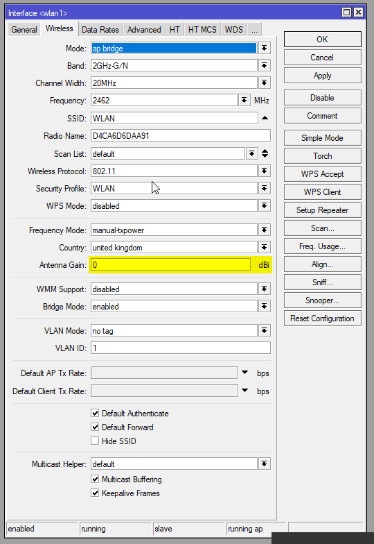

@petri thanks for replying, I never really came to a good solution for this how would you recommend reducing power I’ve read you can increase antenna gain or the tx power.
Either way, the net effect is the same.
I usually set the Frequency Mode to regulatory-domain, Tx Power Mode to default and then adjust the antenna gain. That will protect me from doing anything silly. Check the Status tab for actual power level.
