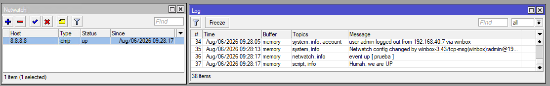

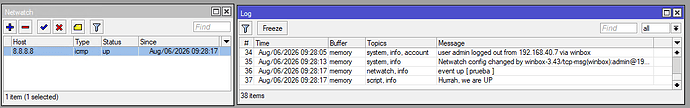

I think I'm not explaining myself clearly. I have just made a test here in a house that has FTTH supplied by Vodafone Spain.
I've added the following netwatch script:
/tool netwatch add accept-icmp-time-exceeded=yes disabled=no down-script=":log info "Damn, we are DOWN"" host=8.8.8.8 http-codes="" interval=30s name=prueba test-script="" timeout=5s ttl=3 type=icmp up-script=":log info "Hurrah, we are UP""
And the results are sadly just what pe1chl predicted :frowning:
Total failure :frowning:
However, if I change the TTL to 5, then the script happily shows: "Hurrah, we are UP" in the logs!

I've testead all the TTLs from 1 to 7, here are the results:
TTL=1 hurrah, we are UP
TTL=2 damn, we are DOWN
TTL=3 damn, we are DOWN
TTL=4 damn, we are DOWN
TTL=5 hurrah, we are UP
TTL=6 hurrah, we are UP
TTL=7 hurrah, we are UP

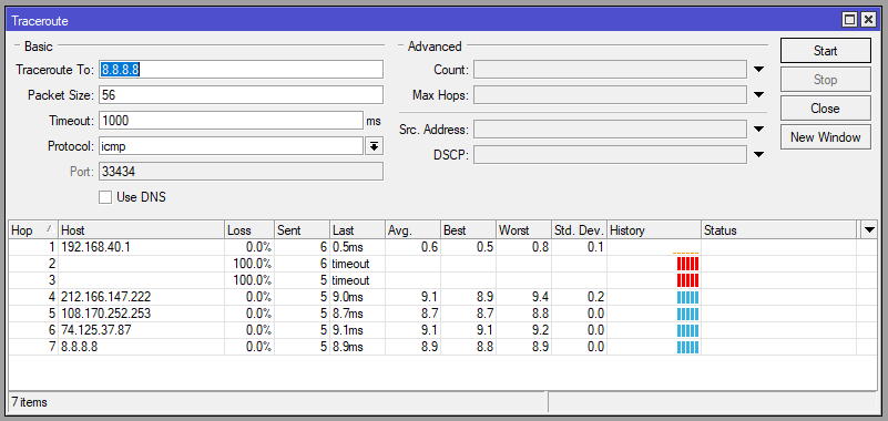

And here's a screenshot of the traceroute to 8.8.8.8 from winbox

What is "wrong" (IMHO) is the DOWN with 4.
Also the downs with lower TTL, but these would make little sense anyway.
In your case, the "right" values are 5 and 6, but if you choose 5 and something changes in your ISP "path towards google" and another (silent) hop is inserted, you might have false downs.
Choosing 6 should be more reliable, still ... :grimacing:
