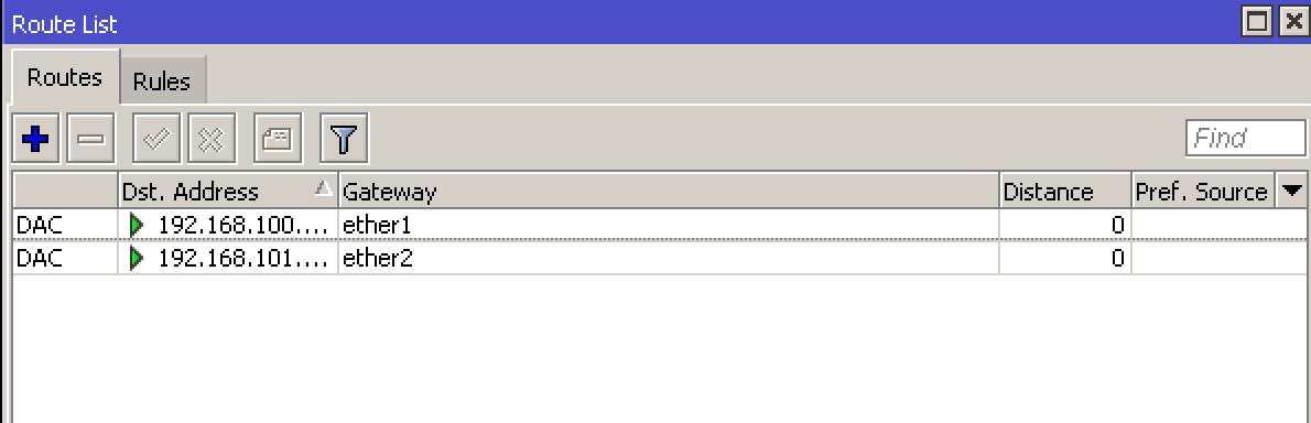

Simple. But in IP > Routes I don’t find any OSPF routes. Where is my mistake?

But there aren’t OSPF routes.

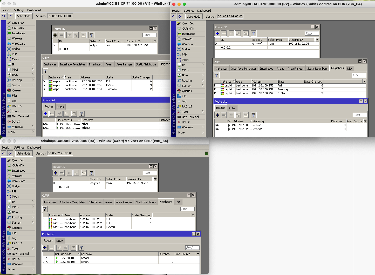

Well, it cost me a lot to see that both R1 and R2 has the same Router-ID: 0.0.0.2. And no, there is no need to publish 192.168.10x.0/24 as you have selected ‘redistribute connected’ in your instance

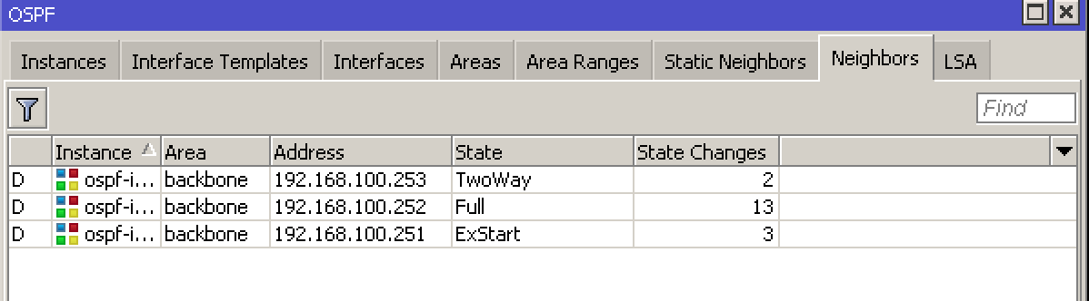

Well, it works with v.7.1.1
Yes, I confirm that. It’s a GNS3 problem: the switch (nor the links?) cut-off DD frame.
The same configuration in a real environment it’s working fine. The same problem occurs using ZTE-ONU to connect Mikrotik RouterOS.

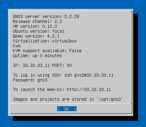

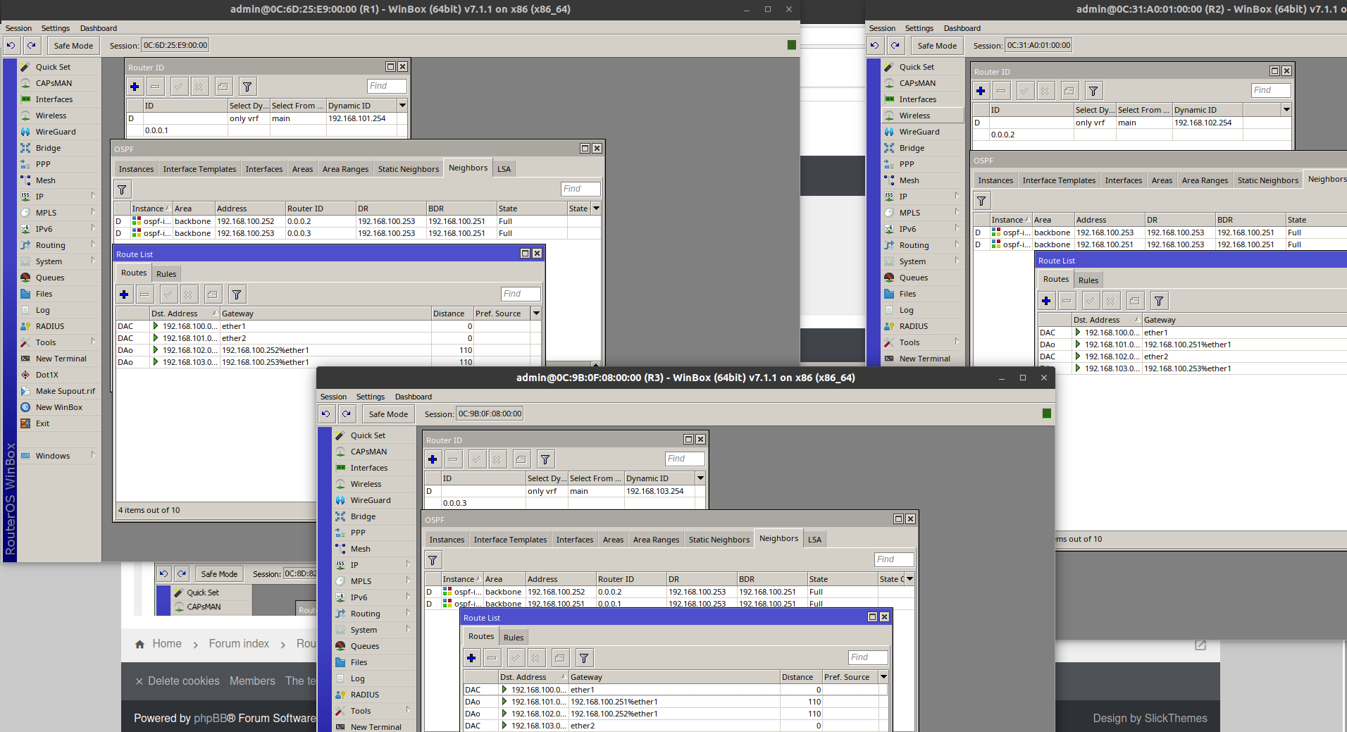

Well, I use gns3 also, latest version in Ubuntu 20.04LTS
Works good, switch also

Can I contact in PM for this? I just want to ask what kind of network card is set in the mikrotik configuration in gns3.
V.
I use X86 architecture with e1000 network card. This way I can test performance, queues… Also I use CHR with virtio when I don’t mind about 1Mbps limit
I use gns3 gui and server locally installed on my laptop: i don’t use Gns3 VM
