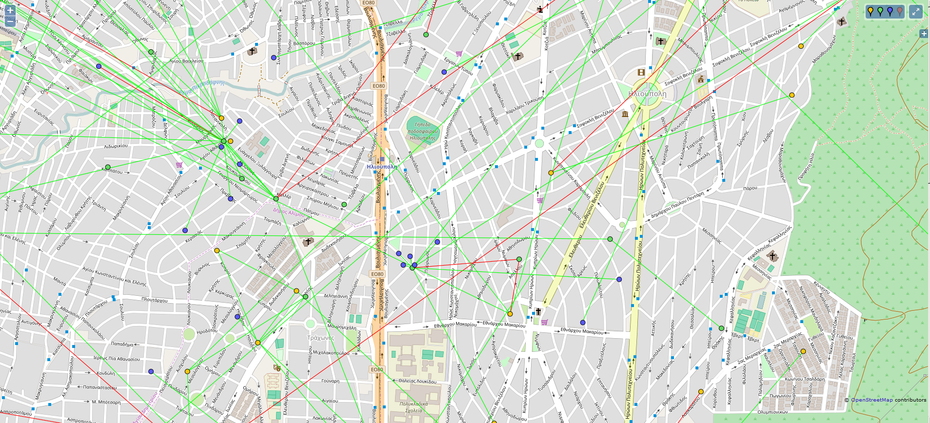

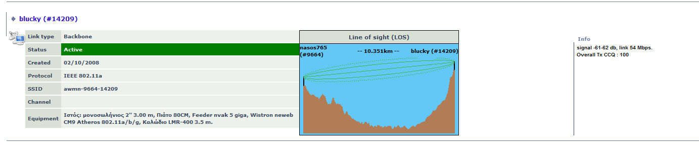

Take a look at the WiND Project. https://github.com/wind-project/wind
It allows you to add nodes to a map and add links between them among other things (ie IP address & DNS allocation).
It will calculate the distance, free space loss, LOS and fresnel zone graphs using NASA’s SRTM data.
Here’s an installation of the system used for AWMN (Athens Wireless Metropolitan Network) https://wind.awmn.net/?session_lang=english
Map View:

LOS View:
