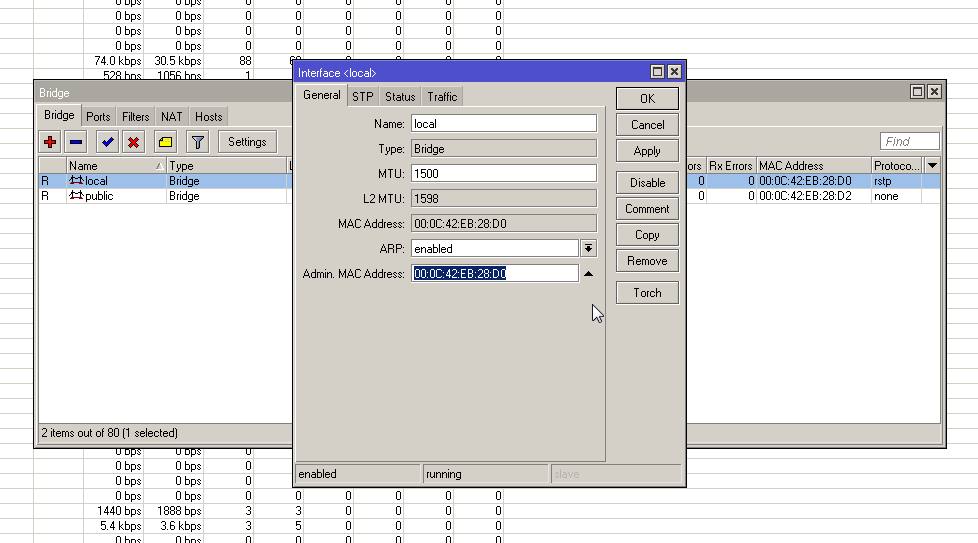

You shoul check if you have admin mac entered on brigded interfaces ..
I dont have any bridges on the routers at the tower, only a loopback interfaces for OSPF to work correctly.
