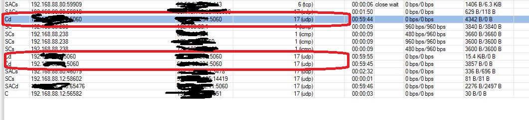

SIP accounts cant register through my Mikrotik Router 951G updated os version 6.42.1. they will be registered successfully when I reset factory the router.
  • there is no any firewall rule for SIP.
  • sip 5060,5061 are enabled in service ports.
I think it happens when my internet IP changes by ISP.
As I checked /ip firewall connections, I found out all UDP connection requests on port 5060 to SIP server are not established.
this problem is disturbing me, please let me know if there is any solution to fix it out.

From you screenshot, I can see your SIP device is destination NATed, I suspect your filrewll filter rules are preventing access
Apply a rule (amend for your environment) as per below, rule order does matter
add action=accept chain=forward comment="Allow if Destination NAT Rule" connection-nat-state=dstnat in-interface-list=WAN

Fine, so it may be time to engage packet sniffing and Wireshark, because otherwise we don’t know what exactly happens. You say that it works after router reboot and goes wrong later so it may be that the connection tracking remembers the previous WAN address after it changes, so the responses from the SIP exchange are sent back to the previous address which is not yours any more (normally use of masquerade rule resolves this, dropping all connections once the public IP address changes, but weird things may happen). Or your SIP exchange may ban re-registrations coming from a different address before the previous registration has expired. Or something else may happen.
