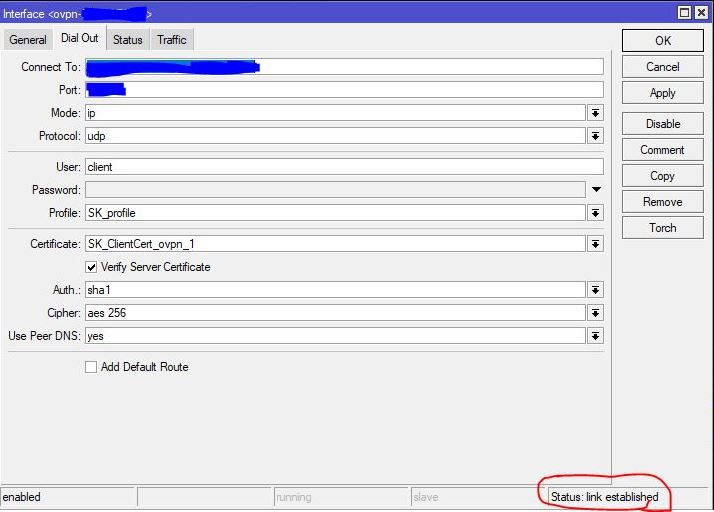

The problem is that - as you saw above - the client config from the .ovpn file doesn’t provide me with any username or password.
Without knowing what to do, I just used a random username and no password
My Ovpn link seemed to be established :
I was very happy at first.
But then i got this on my Logs :
So i think i got two problems, one with encryption and another with authentication.
Even if i figure out something about TLS, how can i implement this on Mikrotik without using credentials ?
The client keeps claiming that he have been told this is possible… :confused:
