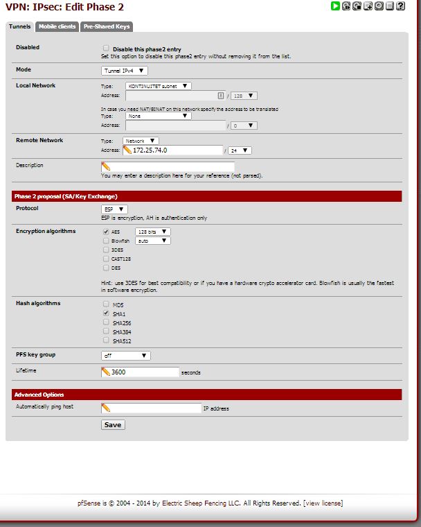

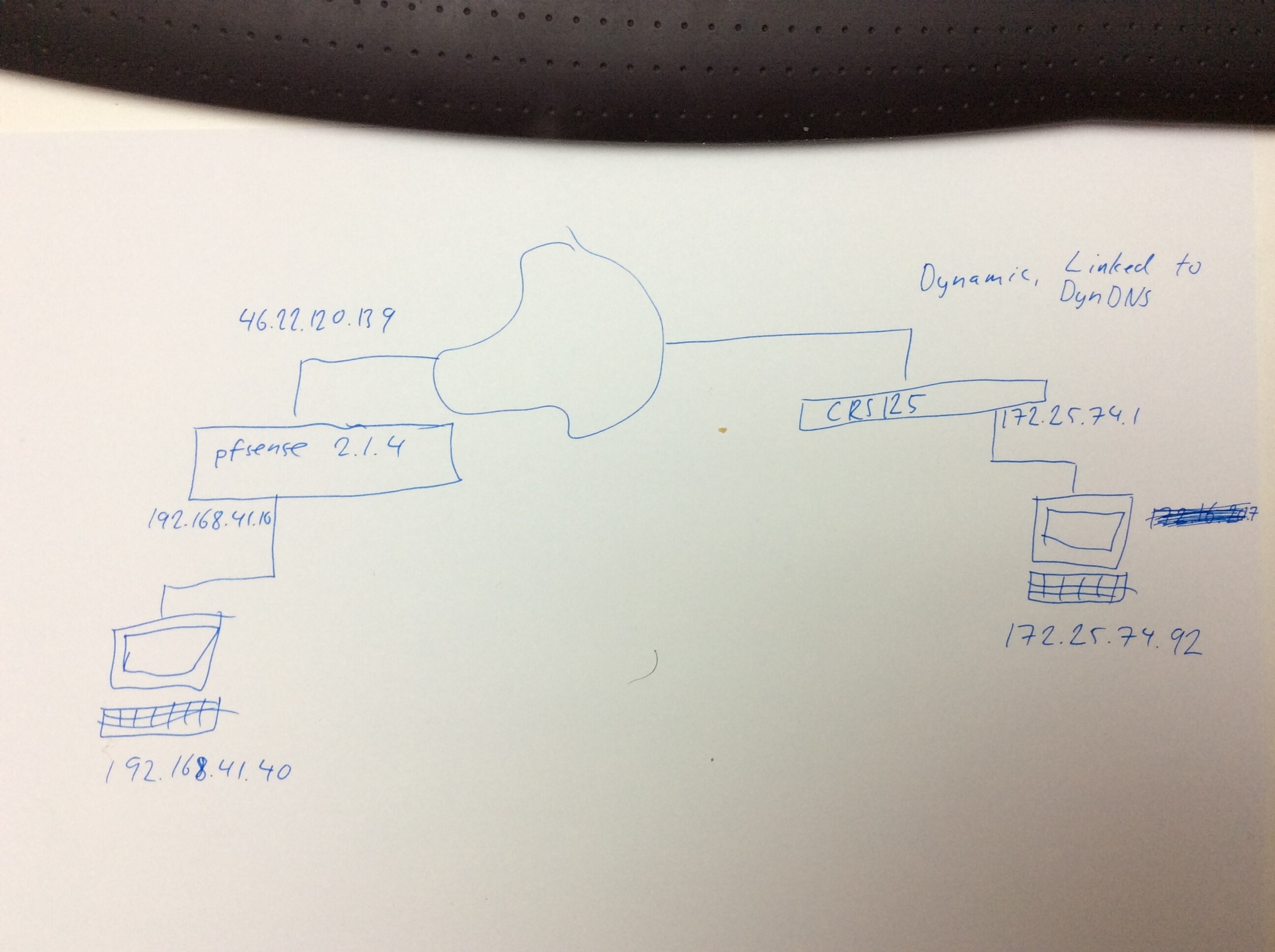

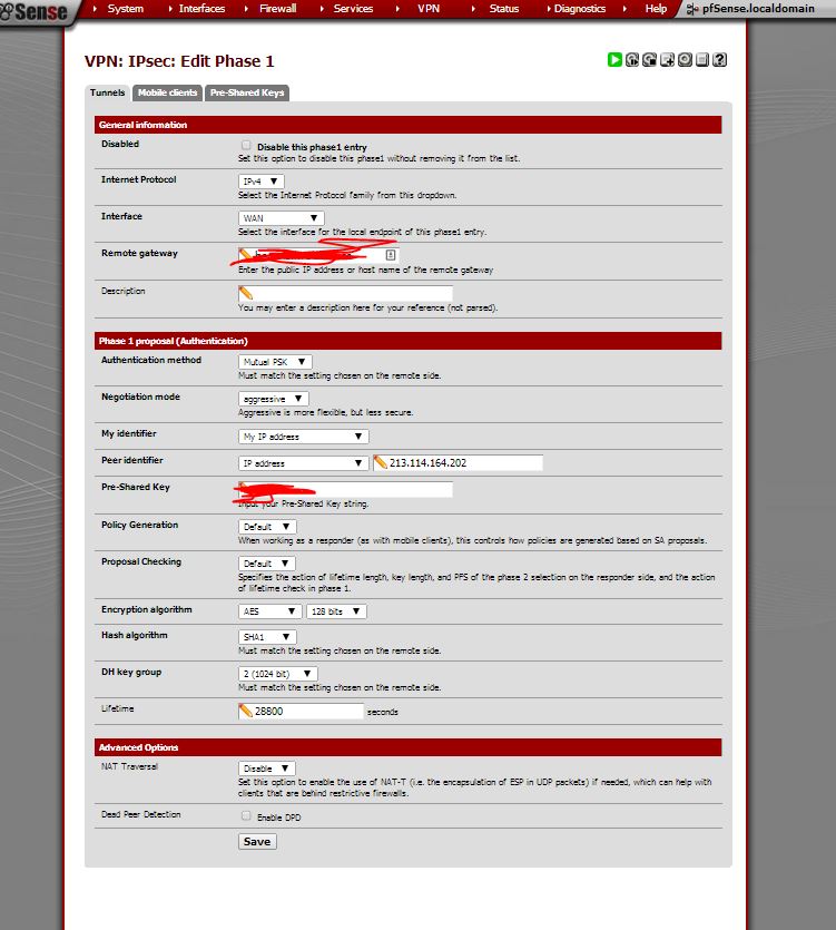

I have attached a quick sketch, and screenshots of pfSense. The machines on both sides have “internet access” via the FW on each side, so routing/nat seem ok. I realize that right now i am using static config in mikrotik. But i figured i would fix a ip-updater once i got something working.

Phase2 settings differ. On ROS you have 3des in Phase2 (default proposal), in pfSense is aes-128 chosen.
Good catch, i suppose thats what happens when you stare at a problem for too long :slight_smile:
But, changing that did not make much difference.

suggestion: try exchange-mode=main
