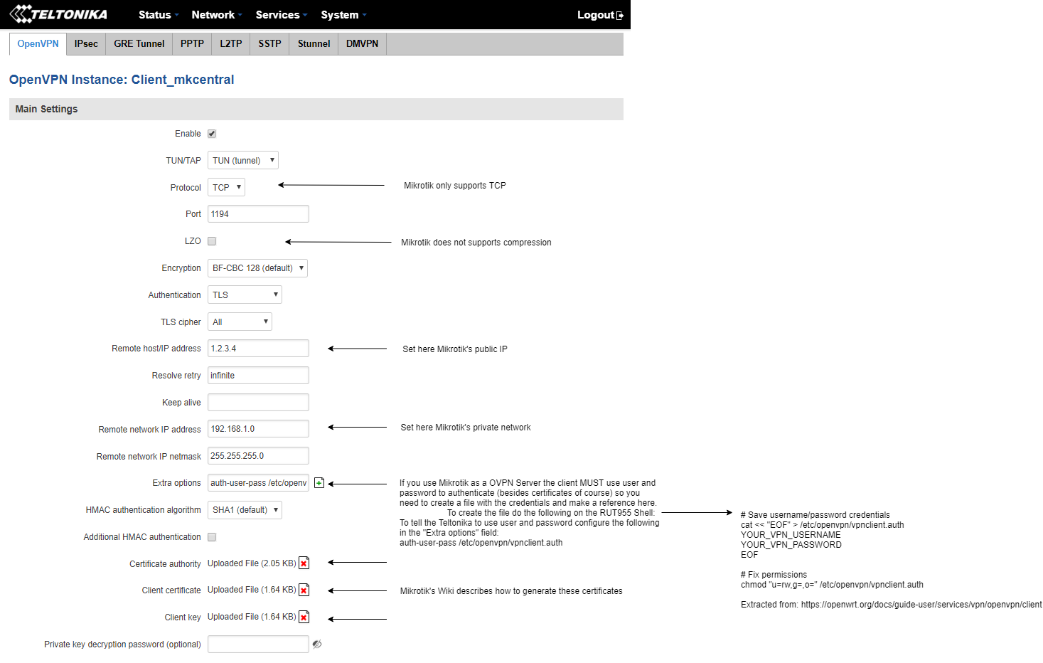

You can follow this document to create certificates for both OVPN server and Client and then go to this article of the wiki to configure the server.
On the Teltonika side you have to load the certificate and configure the OVPN client (the screenshot I sent you).

Here is the RUT955 config, based on your document:
client
nobind
persist-key
auth sha1
ca /lib/uci …
cert /lib/uci …
cipher AES-128-CBC
dev tun_c_rut955_ovpn_client
key /lib/uci …
port 1194
proto tcp-client
remote
resolv-retry infinite
route 192.168.1.0 255 255 255 0
verb 5
auth-user-pass /etc/openvpn/vpnclient.auth

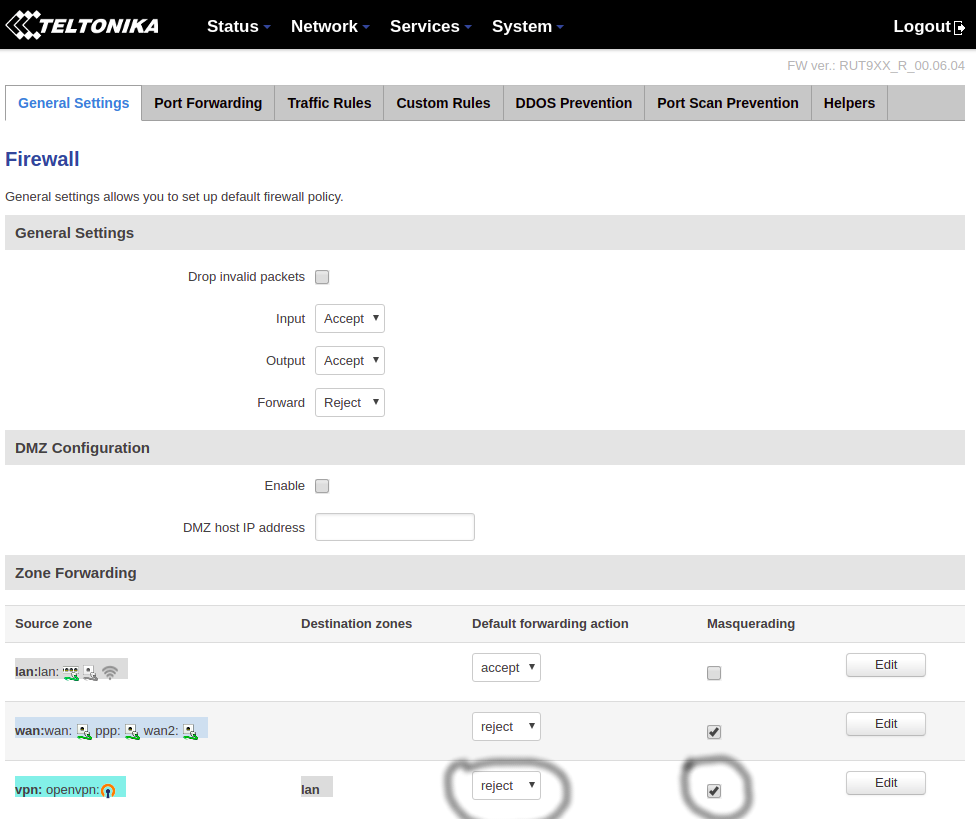

About the last post, as a short answer you should add a /ip firewall filter on input and forward chains to allow traffic from in-interface=to_there at the top of the firewall rule list just in case some other rule is blocking incoming traffic.
Also on the Teltonika you have to unset masquerade and set default action accept for the openvpn tunnel (attached screenshot) on Network–General Settings–Zone Forwarding.

  3. according to Jorge suggestion, I added two firewall rules in the server and modified parameters in the client (firewall, zone forwarding, vpn: accept and no masquerading)
    → cannot always ping the client PCs

So as Jorge has already said, check the firewall configuration on the Teltonika. It seems that it accepts packets coming in through the OpenVPN tunnel (or, from the perspective of the firewall, through interface tun_c_rut955_ovpn_client), which are for its own addresses (172.22.22.2 and 192.168.2.1). These are handled by chain INPUT of the firewall. As we talk about ICMP echo request packets here, this is no surprise as it is the default setting of OpenWRT’s firewall to accept incoming ICMP on any interface
Packets transiting the router from one interface to another are handled by firewall chain forward, and it seems that in this case ICMP echo requests are not permitted, which is also no surprise.
So you can basically either add tun_c_rut955_ovpn_client as another interface to zone LAN, which means that the firewall won’t interfere into communication between the actual LAN subnet and the tunnel (so no protection of one of them from bad guys on the other one), or you can create a dedicated zone for the tun_c_rut955_ovpn_client and define your own rules for forwarding between the zones.

OK, but unless you put the interface representing the tunnel into a zone, only the default rules apply, which say REJECT for forward.
The zone concept just simplifies the rules - traffic between all interfaces in the same zone is unrestricted, whereas the rules for forwarding from any interface in one zone to any interface in another zone are defined in the source zone’s forward chain; input and output chains of each zone control router’s own incoming traffic from any interface in that zone and router’s own outgoing traffic to any interface in that zone. So you don’t need to set up individual rules per particular interface or IP address if you don’t want to.
So as suggested by Jorge, by creating a new zone called VPN, adding the tunnel interface into it, and setting the forward rule VPN->LAN to ACCEPT you allow any client at the the Mikrotik side to establish new connections to servers in Teltonika’s LAN; to permit clients in Teltonika’s LAN to establish new connections to servers at Mikrotik side, you have to set the forward rule LAN->VPN to ACCEPT. If you don’t need to restrict access between hosts in the LAN subnets of Mikrotik and Teltonika, this is all you need.to do at the Teltonika end; Mikrotik’s firewall must also permit the same types of connections so that the end-to-end connections would succeed.

As your suggestion I set the following rules for Teltonika:
vpn to lan accept forward traffic
lan to vpn accept forward traffic
