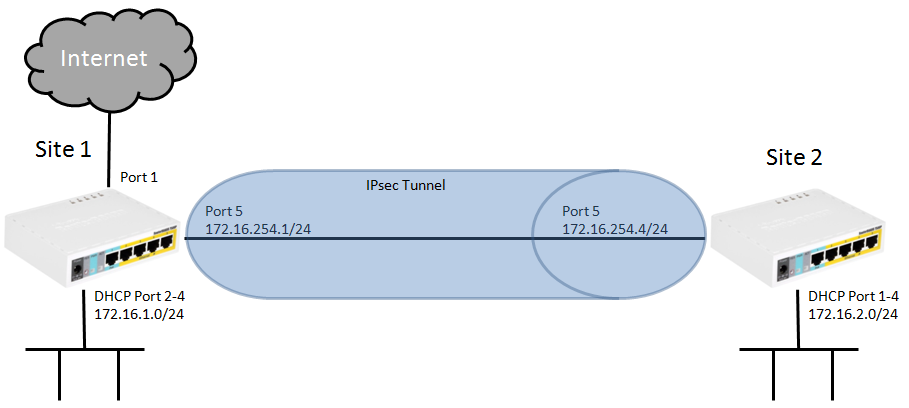

Goal: All traffic between sites must go through the IPsec tunnel.
Traffic from Site 1 to Site 2 and from Site 2 to Site 1 goes through the tunnel using:
Site 1/ip ipsec policy
src-address=172.16.1.0/24 dst-address=172.16.2.0/24 sa-src-address=172.16.254.1 sa-dst-address=172.16.254.2 action=encrypt tunnel=yes ipsec-protocols=espSite 2/ip ipsec policy
src-address=172.16.2.0/24 dst-address=172.16.1.0/24 sa-src-address=172.16.254.4 sa-dst-address=172.16.254.1 action=encrypt tunnel=yes ipsec-protocols=espNow on Site 2, when I change the dst-address to 0.0.0.0/0 in order to put any requests for the Internet through the IPsec tunnel, I lose connectivity to the router from the LAN. I can’t even MAC telnet into the router at that point. How might I add the Internet traffic to the tunnel between sites?
Easiest way would be to set it up with a tunnel (EoIP/GRE/IPIP) over IPSec instead of plain IPSec. … then you just set your default route on the one side to the router at the other end of the tunnel.
Oh and you are loosing lan connectivity because when you add 0.0.0.0/0 to the ipsec rule it is literally encrypting EVERYTHING… even packets locally.
