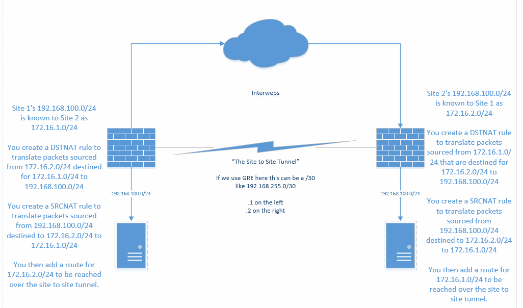

It’s possible to setup a site-to-site VPN between 2 locations with the same IP addressing, 192.168.100.0/24 in your case. That said, configuration complexity jumps a notch. There is a technique called double NAT that can solve your issue. Essentially what you do is either masquerade everything from each site to a single IP, like the IP of the tunnel on each side or you declare a network for each side that isn’t in use on either side and NAT to that network.
