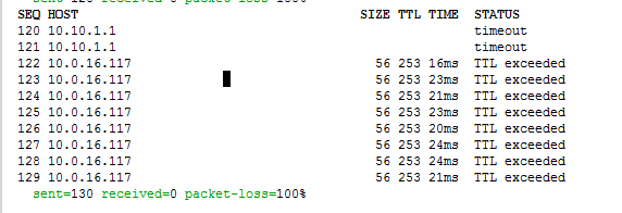

now why am i receiving this?? it seems to reach the destination but then gives that error.
