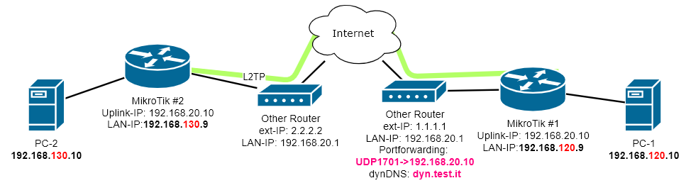

I have a very complicated Setup but I Documented it the attaches PDF.
  • Starting point: Two Mikrotik-RB750Gr3 Routers, both in a private (NAT)-Network.
  • Goal: Establish Site-2-Site Connection between them.
  • Idea:
  • L2TP Connection to establish Link to MikroTik-Router in private Network (Port-Forwarding: UDP 1701)
    • IPSec-Tunnel in L2TP-Connection to get better encryption
Everything works fine, but when the Tunnel is established Pings goes through the tunnel, but e.g. Browsing on the Fileserver (PC1) is not possible.
