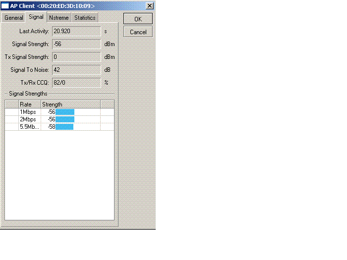

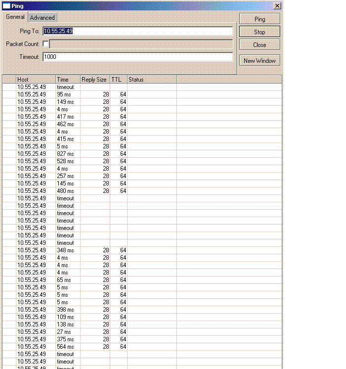

Situation Clients on one AP have extra signal but bad ping
:open_mouth: situation on a AP, client good signal,noise good,bad ping, this is situation with all client on this AP

On this AP is 10 users conect. Minipci R52H ,Polarisation Vertical, B standard ,antena is Sector 14db 120H/30V, This problem hapend couple of day. Users use Yagi and grid antenas.
The pings you showed would look like that if they were moving there the totaled allowed throughput if you are controlling there bandwidth. It also looks about like having someone put 2.4ghz canopy near your location or put a ptp repeater pointed right through your tower. Canopy when talking transmitts over the whole band and only looks like noise to our gear. You could also have one client having problems that can bring the tower to its knees. I once had a client that had a bad networking cable between pc and poe and this cause a lot of retransmitts and caused the tower to have high ping times. So there could be many issues but we do need more info to help you and good luck. Wireless is like blackmagic if it doesn’t work today just wait and use it somewhere else tomorrow and it will be fine.
