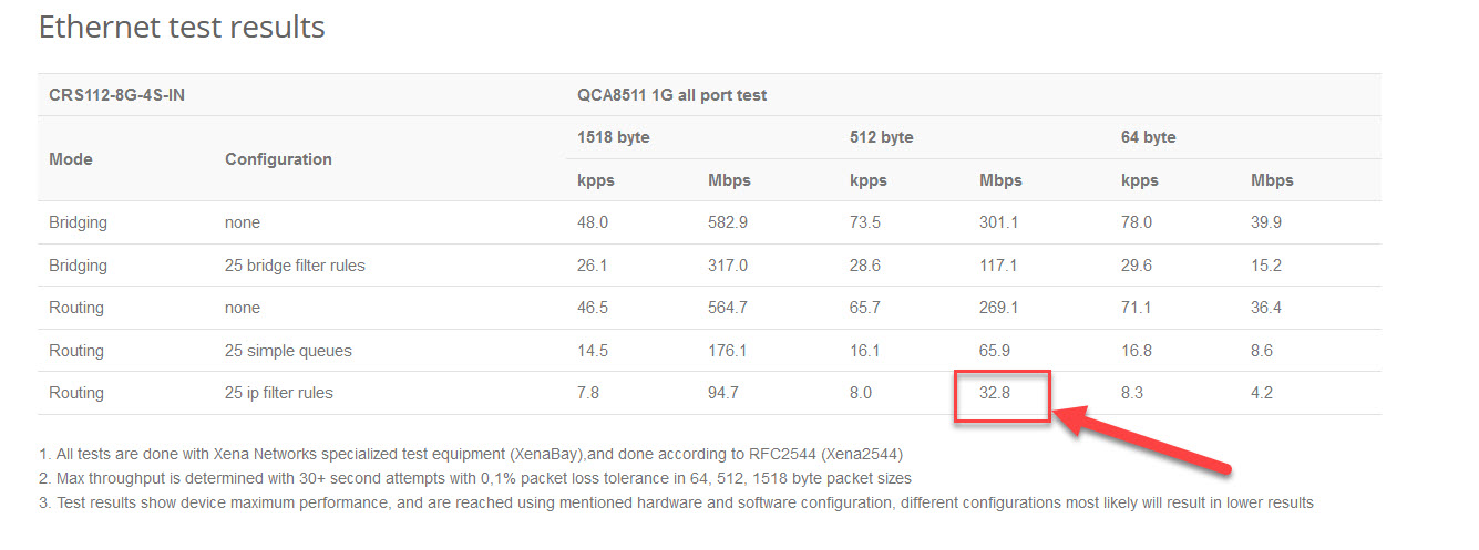

The CRS112-8G-4S-IN won’t be able to handel the Routing of ISP-Speeds of 1Gpbs
If you take a look at the Mikrotik-Webpage (https://mikrotik.com/product/CRS112-8G-4S-IN#fndtn-testresults)
I wouldn’t expect more then 32.8Mbps with this device / configuration
