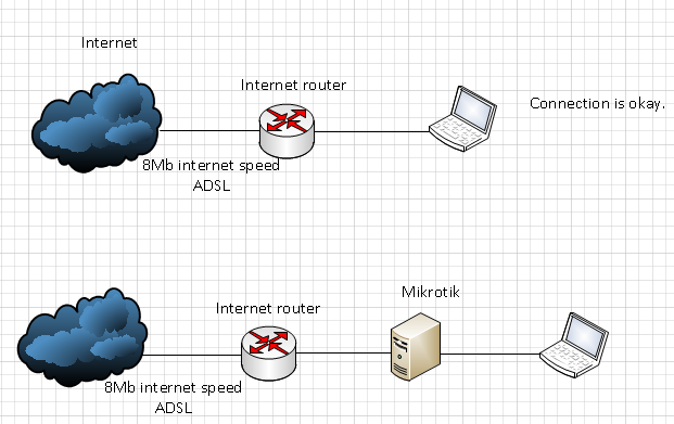

Hi.
Here the scheme.
In above one, connection is okay.
In below, that’s where I have troubles. Pages opening fast in above scheme delay to load here. and during that time, browser says waiting for gogogle.net… stucks there a
while and then slowly load.
Hope it’s enough accurate.
