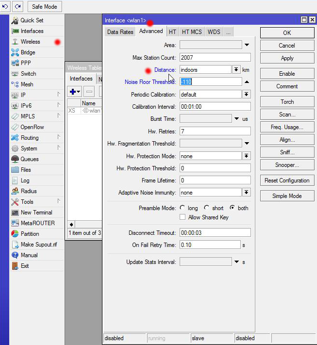

Try to reduce te power, it can be that the signal disturb itselfs
Go to “wireless” click on “advanced”
By “advanced” select “indoors” by “distance”
