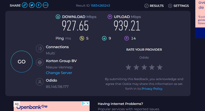

Now im having a weird problem. Everything seems to work fine. When doing a speedtest on Ookla we are getting full line rate speeds.

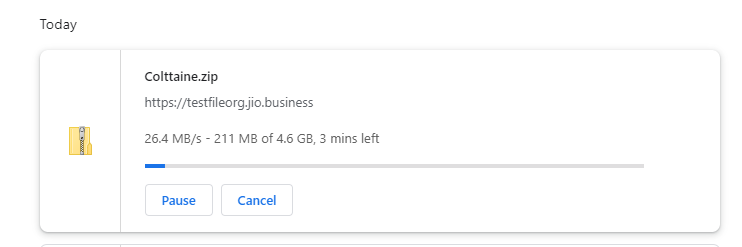

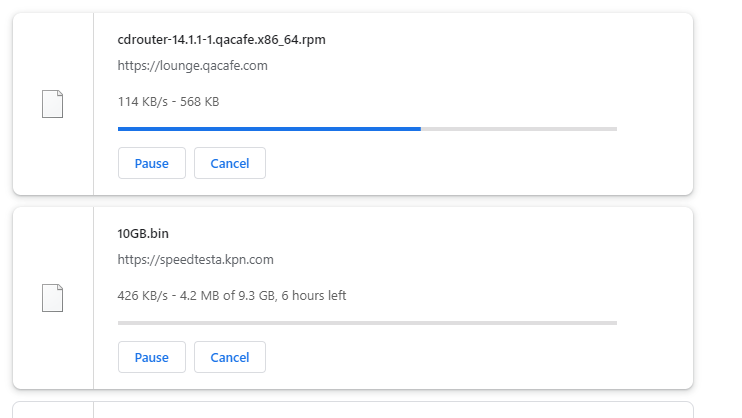

But when we try to download for example a bin file or RPM file from different sources the download is not more then 500Kb. When downloading a zip file for example the speeds are 25Mb. That is already much better. iPerf download test is also around the 25.

Tried it, same speeds as before 234 KB/s
