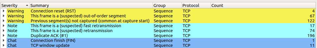

thank you for the instructions, I did the sniffing, but it is difficult to make sense - too much packets.
I noticed, that like 50% (1467 out of 2946) from the packets have
and the sequence seems always to be 1 off:
and so on…

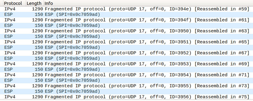

so I ran the sniffing with MTU 1290 und 1000 und get quite a lot Fragments, e.g. with MTU 1280:
Length of 1290 is OK, I guess ? (for MTU 1000 it was 1010)
Do I need to set MTU 1280 on the bridges as well and maybe somewhere else too?

I have no clue whether this happens due to different MTU as such, but something on the path between the routers indeed does fragment the packets in another way. An ESP packet with SPI 0x0c6f3159 and sequence number 97155 is sent as a 1514-byte frame carrying the first fragment and a 150-byte fragment carrying the second and last one from router A, and it arrives to Router B as three frames - a 770-byte one, a 778-byte one, and a 126-byte one. So something between Router A and Router B reassembles the original packet and fragments it in this weird way. Especially the fact that the first two fragments have a different size puzzles me.
As said - since the routers have problems with sniffing, I’m afraid the CPU load during the test is too high, so anything can happen. The manual explicitly prohibits using bandwidth-test on the router whose throughput capability you test, so using an external device (another router or a Linux/Windows machine with iperf) at both ends would remove this doubt.

I did not use test generator/responder, when doing “sniffs” - I just generated some traffic from Device B…
I could also probably try to sniff the traffic on the Fritzboxes - they provide such functionality, then it would be hopefully be clear who fragments the packets.
