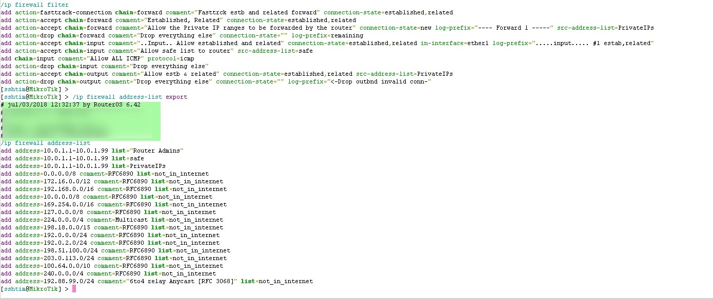

Btw, your firewall for forward is only three active rules:
add action=fasttrack-connection chain=forward connection-state=established,related
add action=accept chain=forward connection-state=established,related
add action=accept chain=forward connection-state=new src-address-list=PrivateIPs
and since default action is accept, it makes it wide open for anything. You might want do to something about that.
Thanks again for your help!
I would appreciate any suggestions on best way to improve rules.
I would suggest removing those blacklist downloads, they pose a huge security risk. If someone is able to MITM your connection or the web host is compromised, your router is compromised since it’s essentially executing arbitrary commands from a remote host (!).

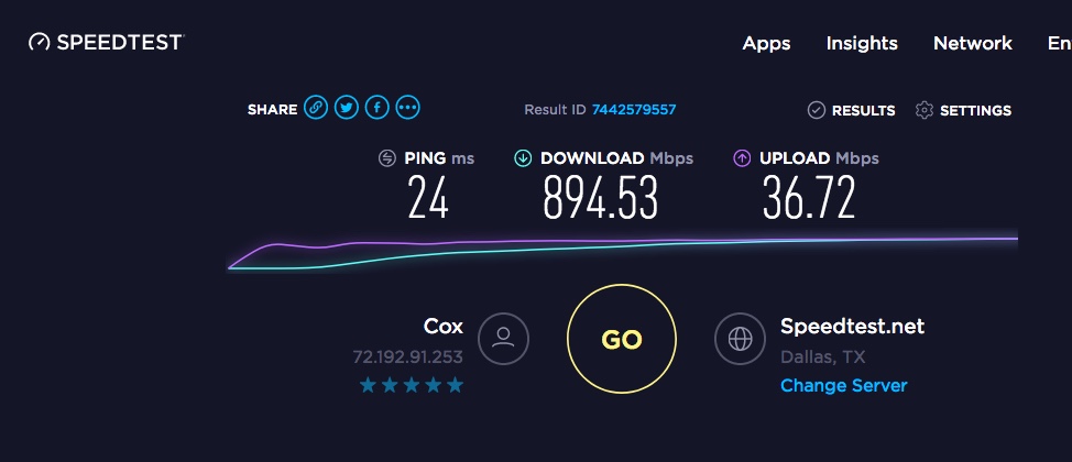

Have made some changes to firewall rules and address lists
Now performance almost 900mbit!
Suggesstions welcomed!
