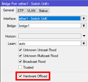

If you go to Bridge > Port, click on each ether interface, and see whether hardware offload is checked.
Can you post your bridge port and interface list.
Thank you very much for the prompt answer . I link bellow a screenshot of the interfaces and bridge port . I checked and all the interfaces have hardware offload ticked already . Do you have another idea ?
