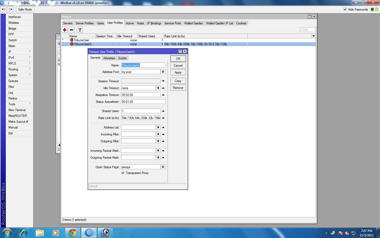

I have this small network setup where I used MK router RB800 where users connect through hotspot setup: I Setup four wireless router(linksys routers). The routers were setup just as bridge to my MK router.Ether1 host the incoming internet link, a cable from ether2 to a switch (8ports) then the router were connected to the switch.Then configure bandwidth sharing as shown in attached. What could be the cause of slow internet browsing? Though at times I have close to fifty users connected concurrently.
NB: I subscribe for 2MBps fiber optics connections.
Any Idea Please.

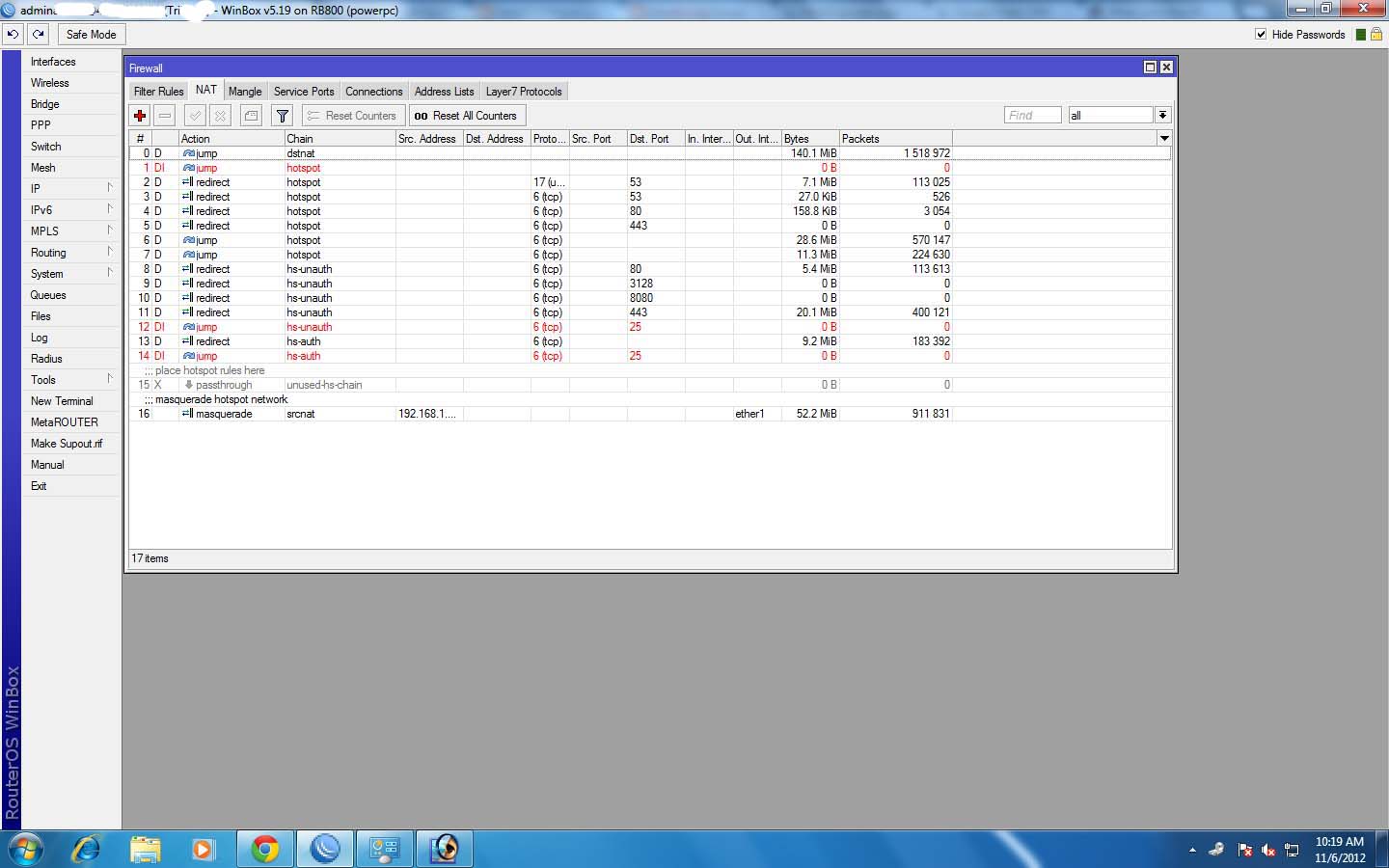

Check out my Firewall rule, I noticed that my router is blocking some sites as well because if I browse those sites directly I could access them.

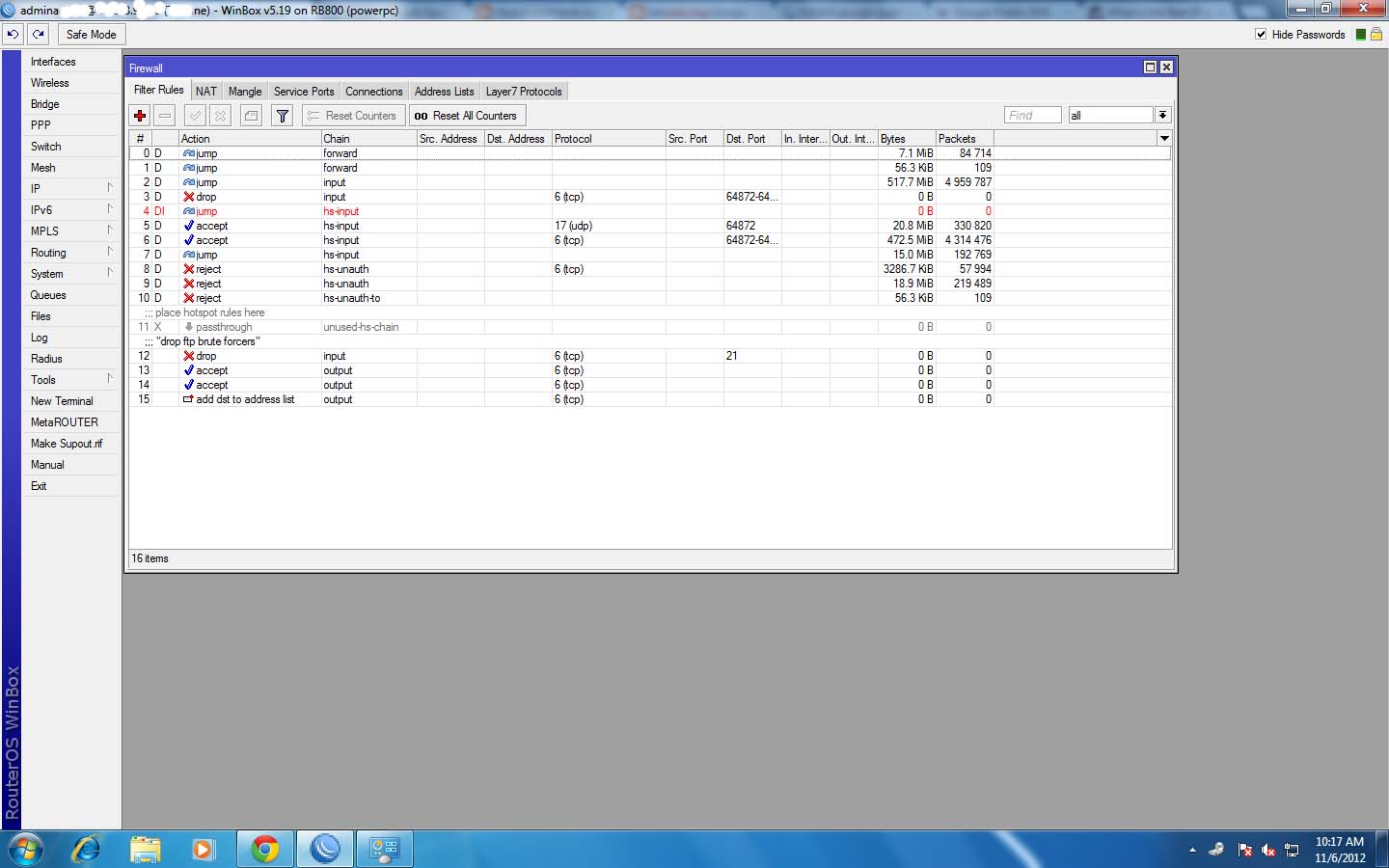

Doveman,
Forget about printscreens when asking for a conig check. It’s not working that way.
Form the printscreens I can only see that you have actually no firewall on forward chain. I do not see how you can tell that out of these images that anything is dropped in firewall forward. All I see are the drops on hs-unauth chain.
Send a config expo and I’ll try to help, but otherwise, I can only suggest on possible errors.
And by the way, this still sound like a faulty DNS server settings.
