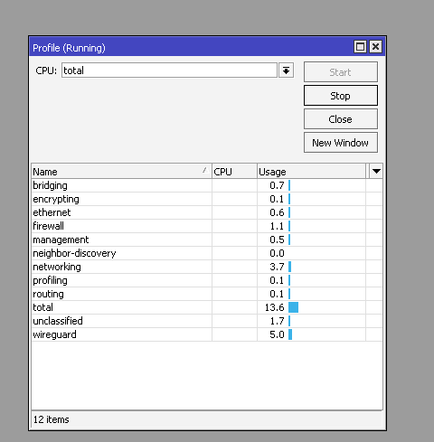

I did watch the CPU usuage when doing a speedtest and it’s not like it is hitting 100% on the upload part of the test, it’s around 20 during download and doesn’t even hit 10 during the upload.
If observing CPU usage under system resources … that one is average and single-core tasks won’t trigger it to go very high (depending on number of CPU cored in your device). It’s better to run CPU profiler to see, if one of CPU cores gets pegged and which process causes it.

I also don’t see any high CPU usage, this is a screenshot while doing the upload part of a speedtest (I assume this is what you meant with profiler?):
Yup. But select “CPU: all” to see if one single core gets maxed out (CPU: total gives averages, which are useless in this case).
