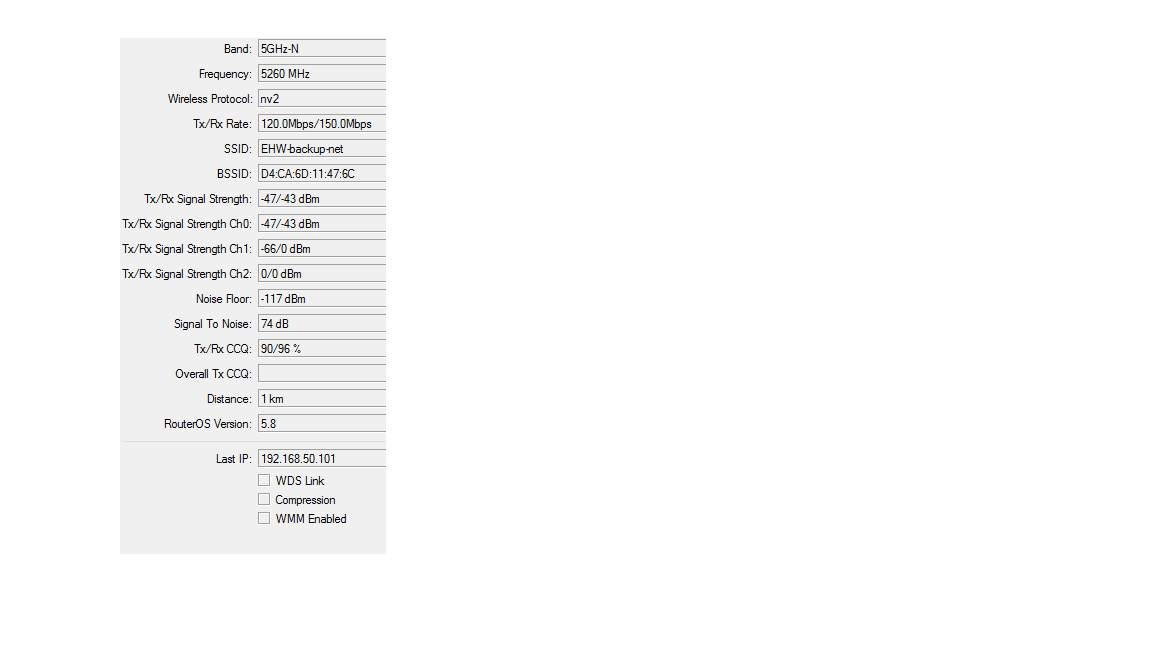

made some changes implemented nstreme and nv2 still lucky to get above 20Mbs
using sector antennas (not sure of exact model as inherited this project) and a router board RB435G as central point, sextants SXT 5HnD connecting to this

Signal is too high, set power to give -50+ , SNR is very high and probally caused by RF overloading, what is your CCQ?
do not appear to have the ability to turn the power down on the Sextant or am missing something?
