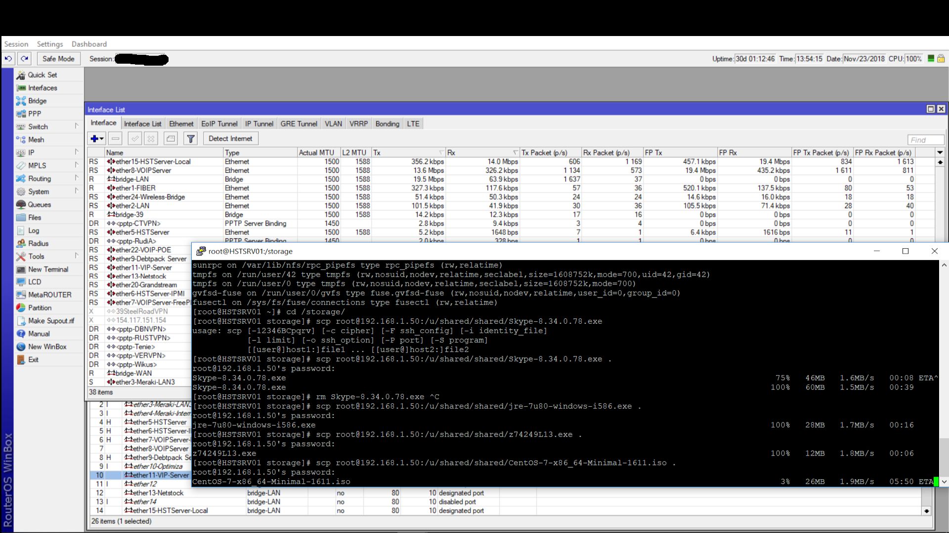

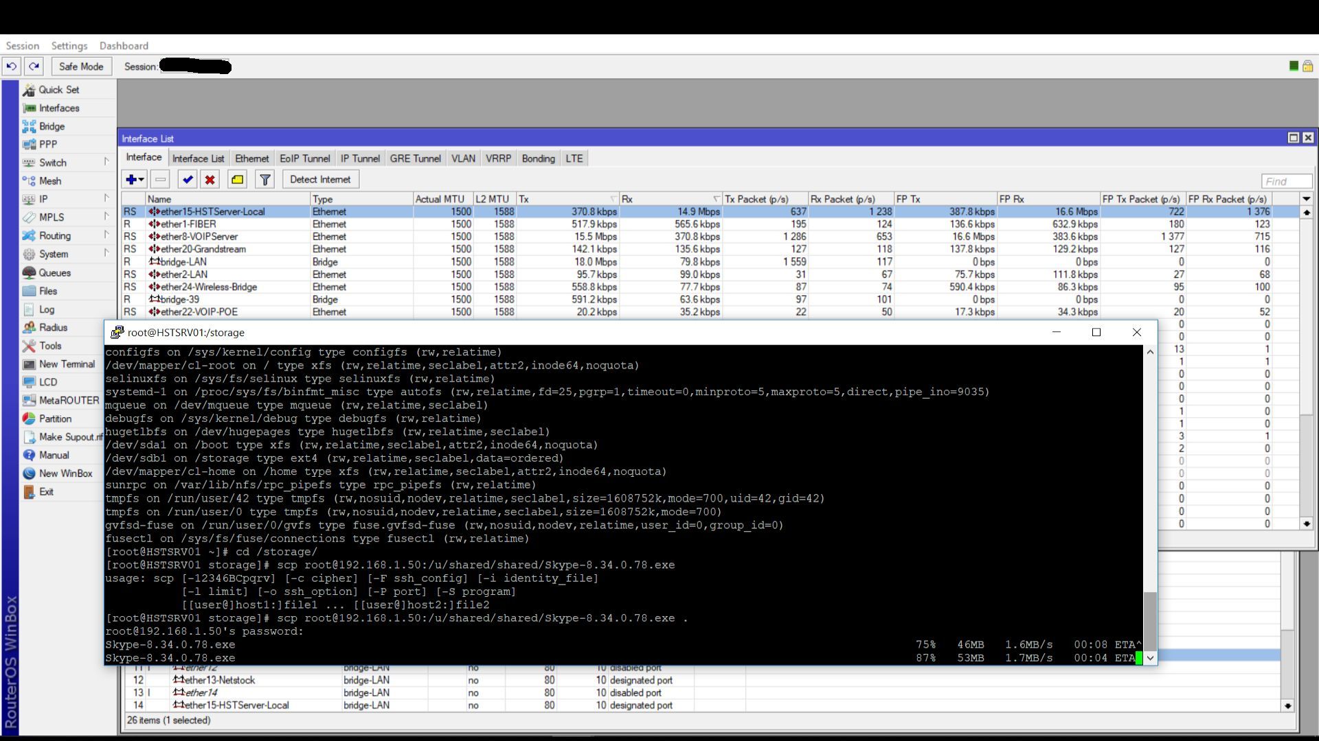

Copying a file from 1 Linux server to another copies at about 888.1KB/s. The one server is connected to port 15 and the other connected to port 5

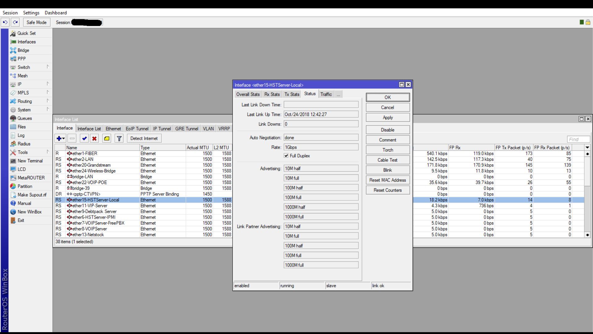

Running the bandwidth test between the two switches gets upto about 19Mbps RX and 5Mbps TX.
I have tested the CAT5e cables with a Fluke “CableIQ” tester and they all tested for 1Gbps.
The Linux servers report connections of 1Gbps as well
Settings for eth0:
        Supported ports: [ TP ]
        Supported link modes:   10baseT/Half 10baseT/Full
                                100baseT/Half 100baseT/Full
                                1000baseT/Full
        Supported pause frame use: No
        Supports auto-negotiation: Yes
        Advertised link modes:  Not reported
        Advertised pause frame use: No
        Advertised auto-negotiation: Yes
        Speed: 1000Mb/s
        Duplex: Full
        Port: Twisted Pair
        PHYAD: 0
        Transceiver: internal
        Auto-negotiation: on
        MDI-X: Unknown

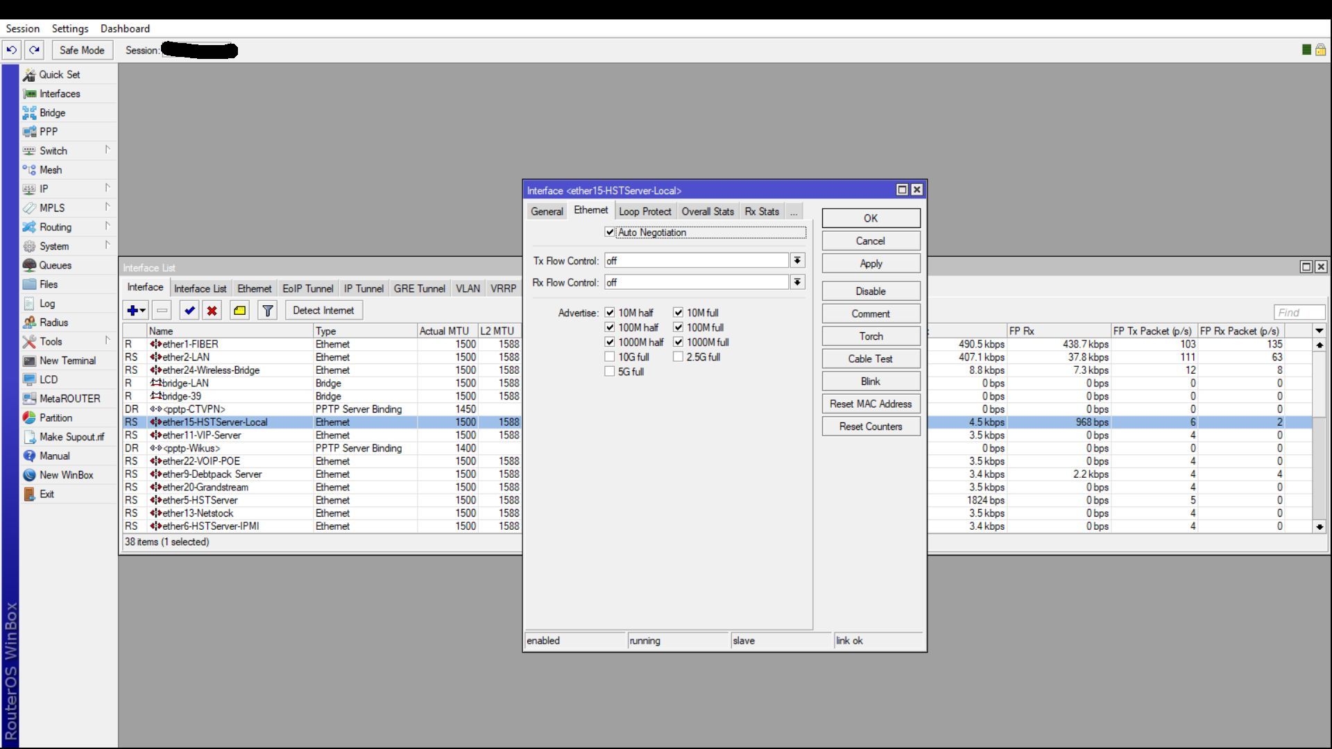

add fast-forward=no name=bridge-39
add fast-forward=no name=bridge-LAN
add fast-forward=no name=bridge-WAN
set [ find default-name=ether1 ] name=ether1-FIBER speed=100Mbps
set [ find default-name=ether2 ] name=ether2-LAN speed=100Mbps
set [ find default-name=ether3 ] name=ether3-Meraki-LAN3 speed=100Mbps
set [ find default-name=ether4 ] name=ether4-Meraki-Internet1 speed=100Mbps
set [ find default-name=ether5 ] name=ether5-HSTServer speed=100Mbps
set [ find default-name=ether6 ] name=ether6-HSTServer-IPMI speed=100Mbps
set [ find default-name=ether7 ] name=ether7-VOIPServer speed=100Mbps
set [ find default-name=ether8 ] name=ether8-VOIPServer-IPMI speed=100Mbps
set [ find default-name=ether9 ] name="ether9-Debtpack Server" speed=100Mbps
set [ find default-name=ether10 ] name=ether10-Optimiza speed=100Mbps
set [ find default-name=ether11 ] name=ether11-VIP-Server speed=100Mbps
set [ find default-name=ether12 ] speed=100Mbps
set [ find default-name=ether13 ] name=ether13-Netstock speed=100Mbps
set [ find default-name=ether14 ] speed=100Mbps
set [ find default-name=ether15 ] name=ether15-HSTServer-Local speed=100Mbps
set [ find default-name=ether16 ] speed=100Mbps
set [ find default-name=ether17 ] speed=100Mbps
set [ find default-name=ether18 ] speed=100Mbps
set [ find default-name=ether19 ] speed=100Mbps
set [ find default-name=ether20 ] name=ether20-Grandstream speed=100Mbps
set [ find default-name=ether21 ] speed=100Mbps
set [ find default-name=ether22 ] name=ether22-VOIP-POE speed=100Mbps
set [ find default-name=ether23 ] name=ether23-Wifi-AP speed=100Mbps
set [ find default-name=ether24 ] name=ether24-Wireless-Bridge speed=100Mbps
set [ find default-name=sfp-sfpplus1 ] advertise=10M-half,10M-full,100M-half,100M-full,1000M-half,1000M-full
set [ find default-name=sfpplus2 ] advertise=10M-half,10M-full,100M-half,100M-full,1000M-half,1000M-full

HW offload is unticked on all the ports. I had it ticked but it didn’t make any difference.
Where exactly should I look?
No, I haven’t changed any MTU settings. I didn’t think it is / was necessary. It’s 1500 on all ports.
I am not sure I understand the question? Buying new switches are not an option.

When you do the transfer test, what is the cpu usage?
I think this is a MikroTik design flaw? The interface stats show 1Gbps, as per the screenshots
It didn’t improve the network throughput though, hence being at that time when I exported.
The test in Clipboard06 was done with hardware loading=on
I have some firewall rules in place, as well as queues. Do I not need those then?
This is an internet facing router, surely this is needed?
As above
I was sniffing at that time, but not active the whole time.
Please explain, what do you see that could be optimized??
It jumps between 28% and 50%-65% under normal use. With a large file copy it goes to 100%, as per the last screenshots.
