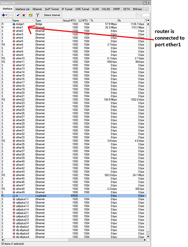

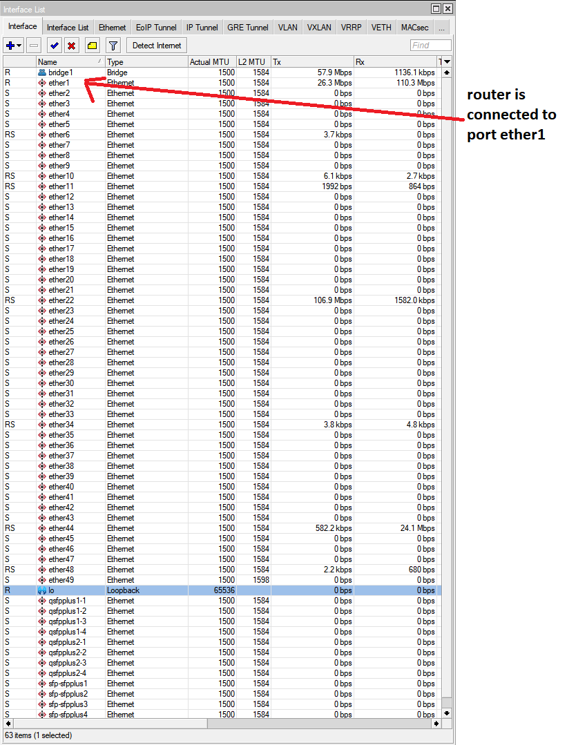

“H” question i think no ( i added screen)

Your switch is still working as a router. You have masquerade rule in place. You have DHCP server.
I don’t remember if CRS354 (and I configured one 2 months ago :laughing: ) is by default configured as a switch but try to reset it to default configuration.
as you said it it makes sens. I did reset it and everything is working fine. All pc are working at full speed.
