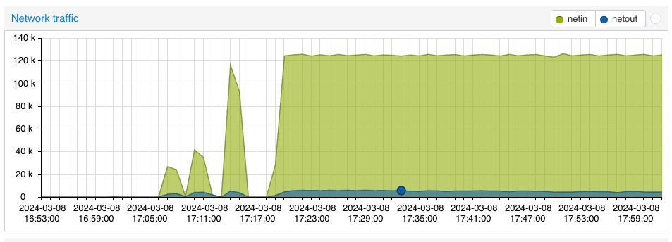

Mikrotik ‘webfig’ displaying average Tx/Rx Packet = 80 p/s
I am requesting help for where to look, how to troubleshoot (not necessarily solve)
