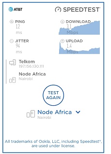

Here is an internet speed test i did
I should mention that my mast (pole that is holding my Mikrotik LHG 5ac arm) is long and not perfectly still. When it is windy it sways slightly, which i notice affects my download speeds slightly. Can this affect upload speeds severely?? Because if it is affecting my downloads slightly and only when it is windy, i think it should only affect my upload speeds slightly.. I barely get more than 0.11 Mbps.
My question is, why am I getting extremely slow upload speeds?

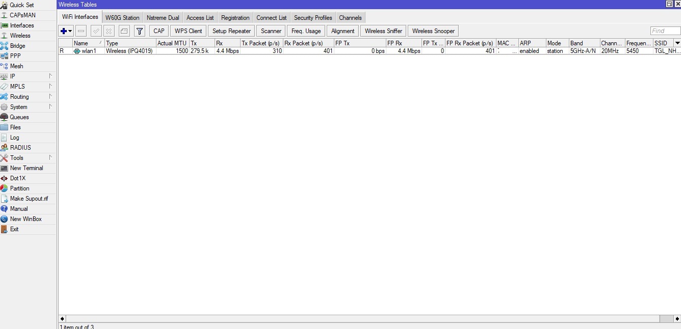

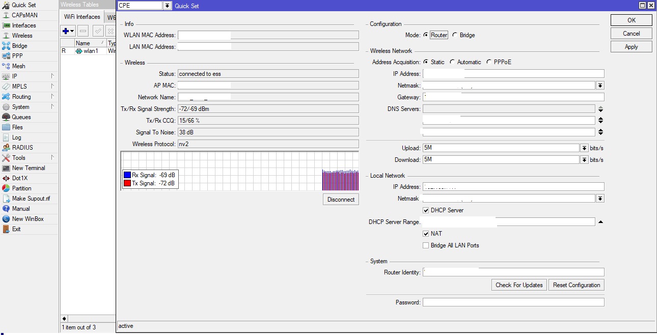

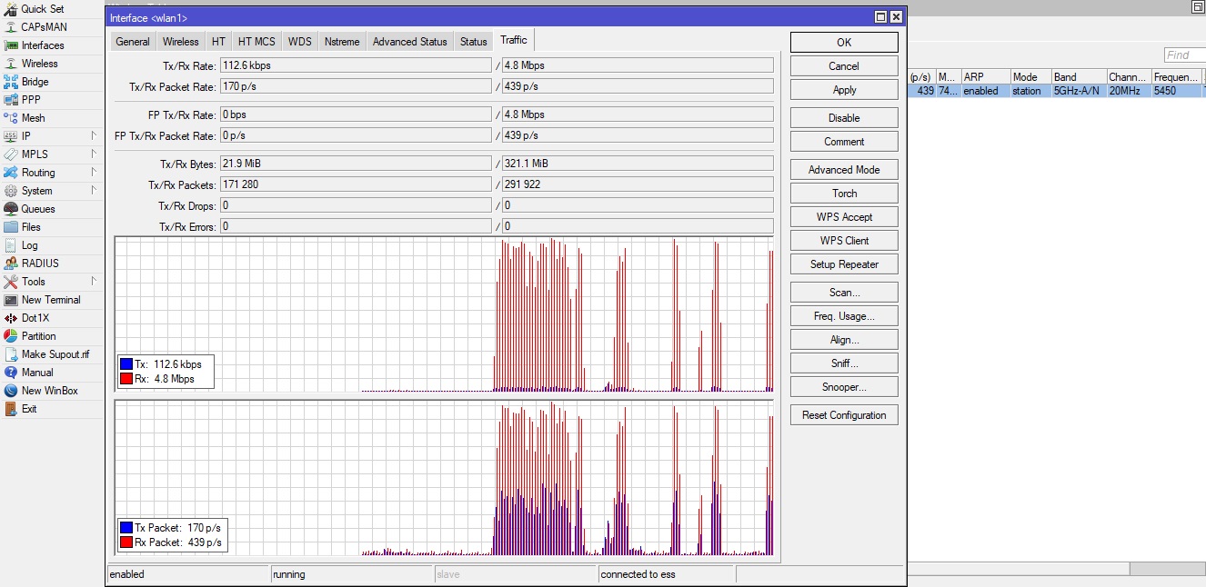

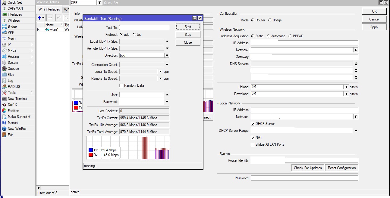

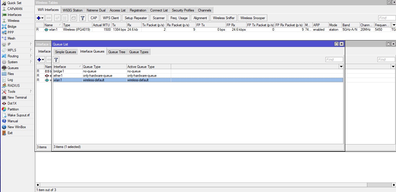

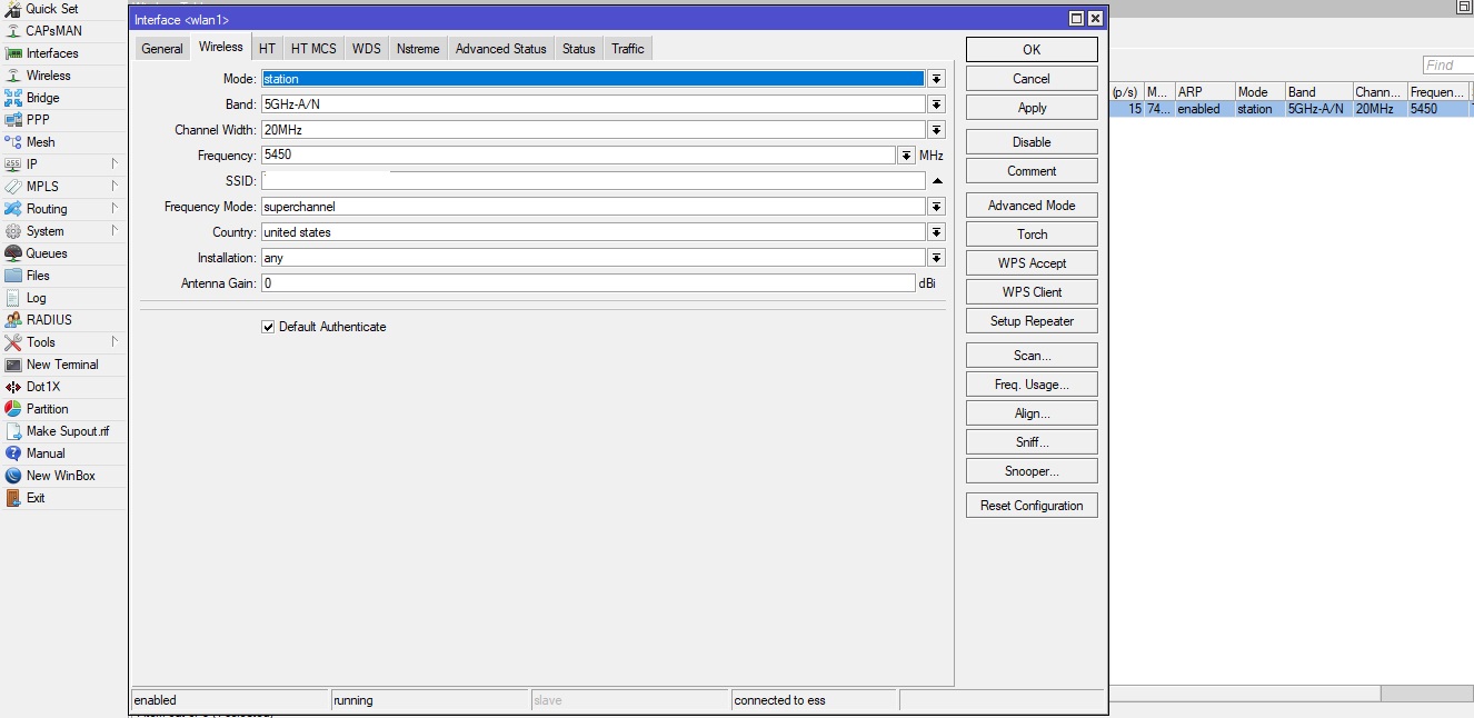

Here are some screenshots of my receiver/router winbox settings to help you see where I might be wrong.
I don’t have the winbox configuration for my ISP’s access point.

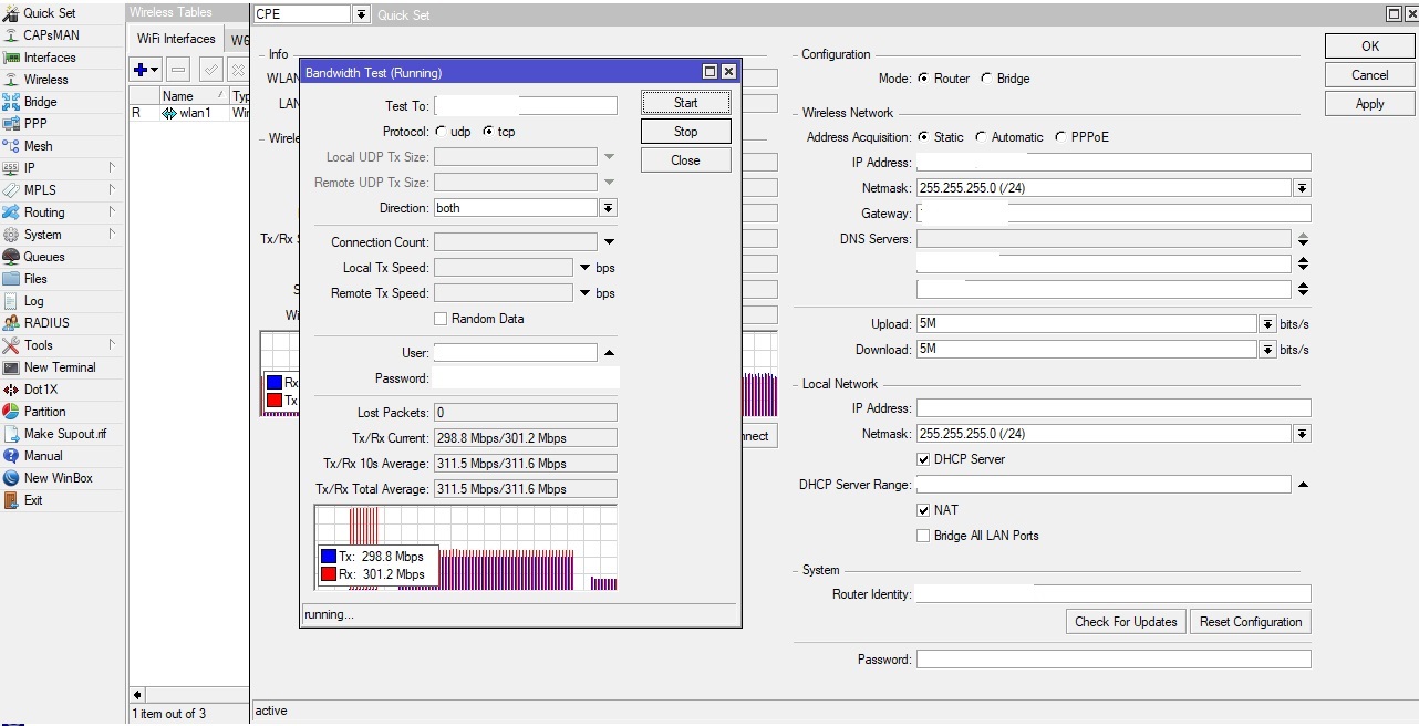

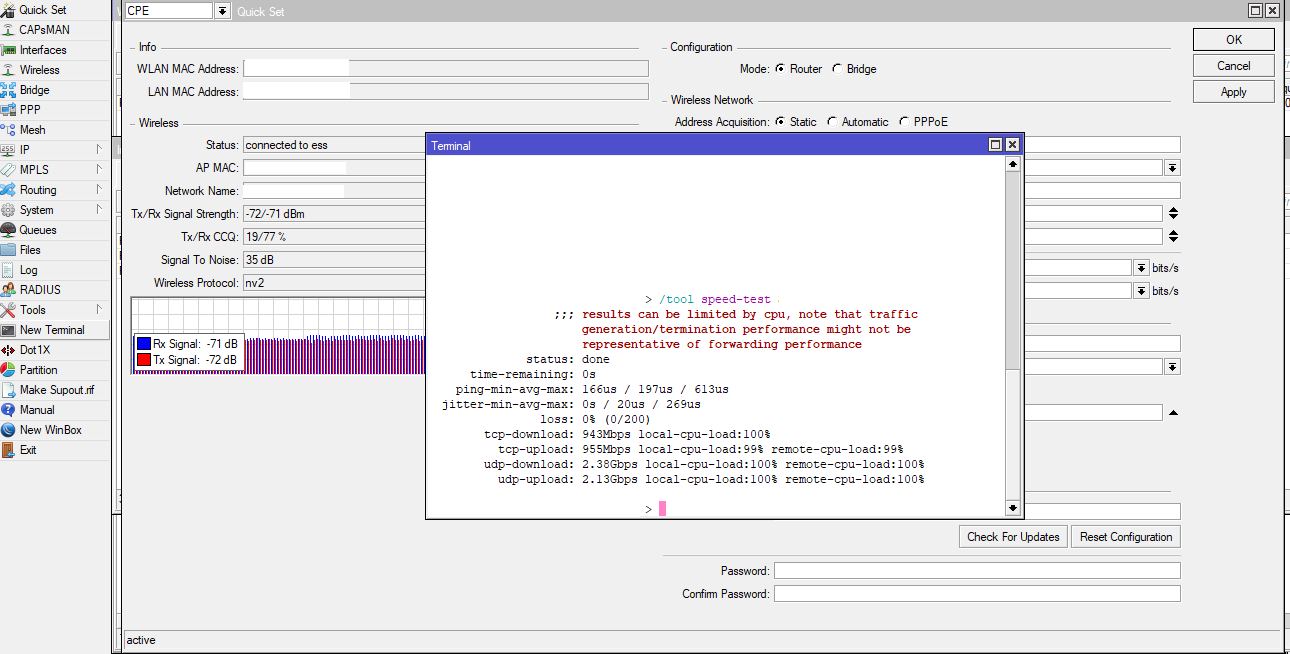

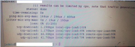

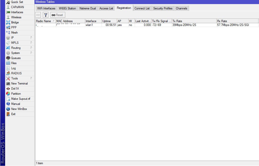

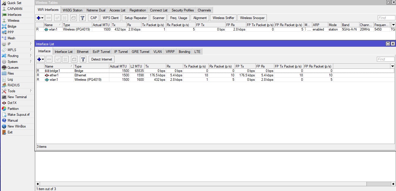

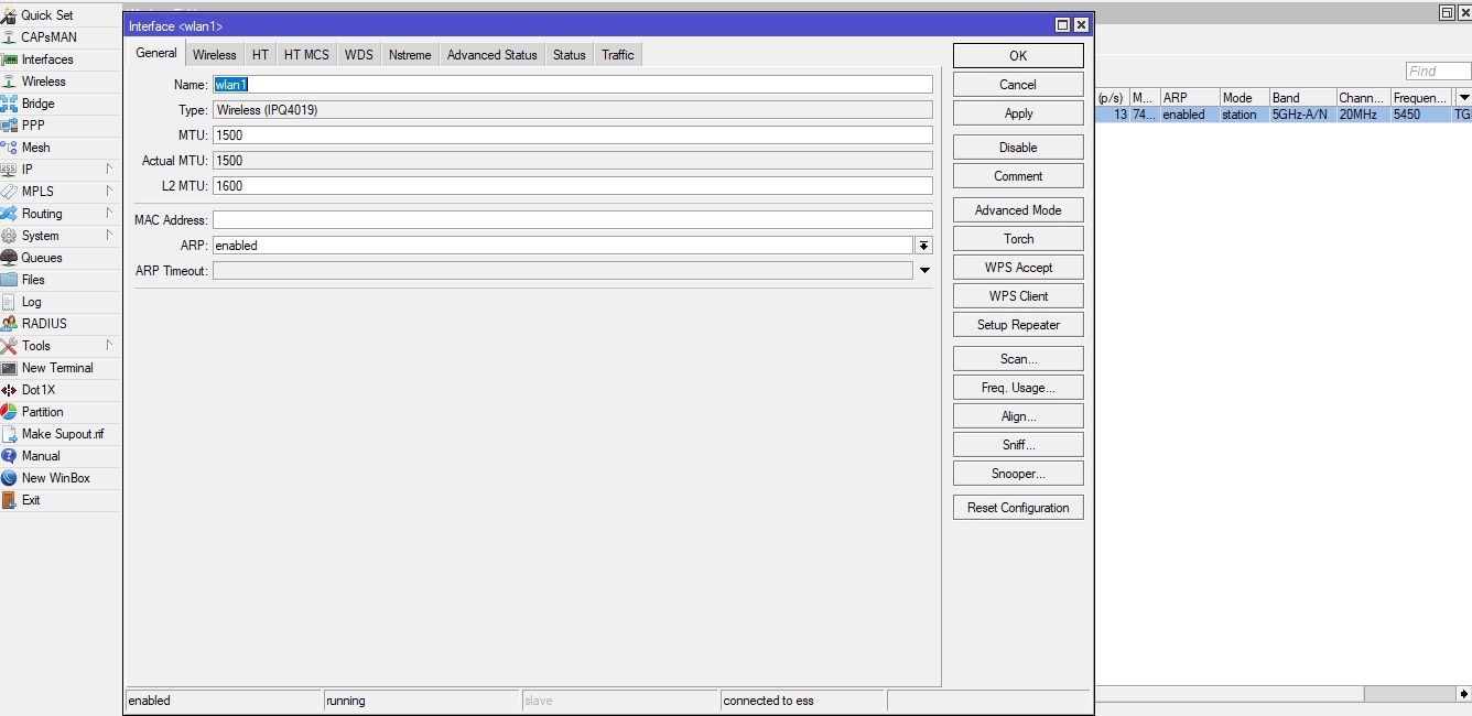

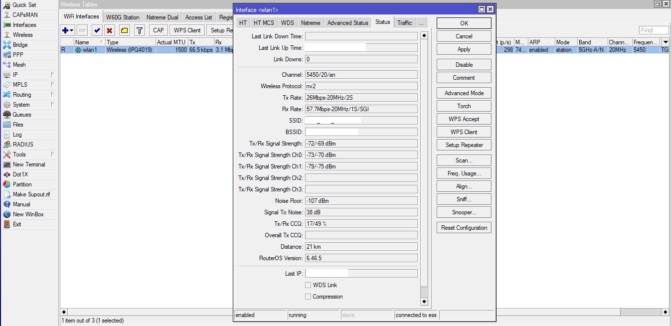

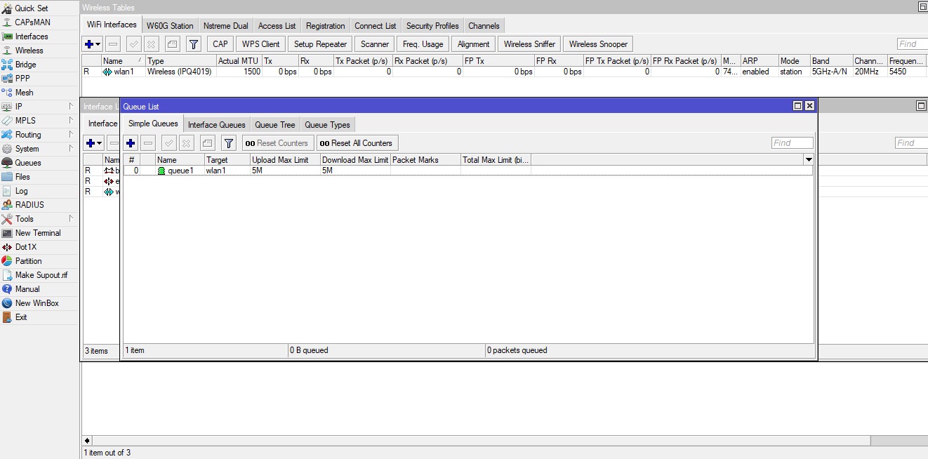

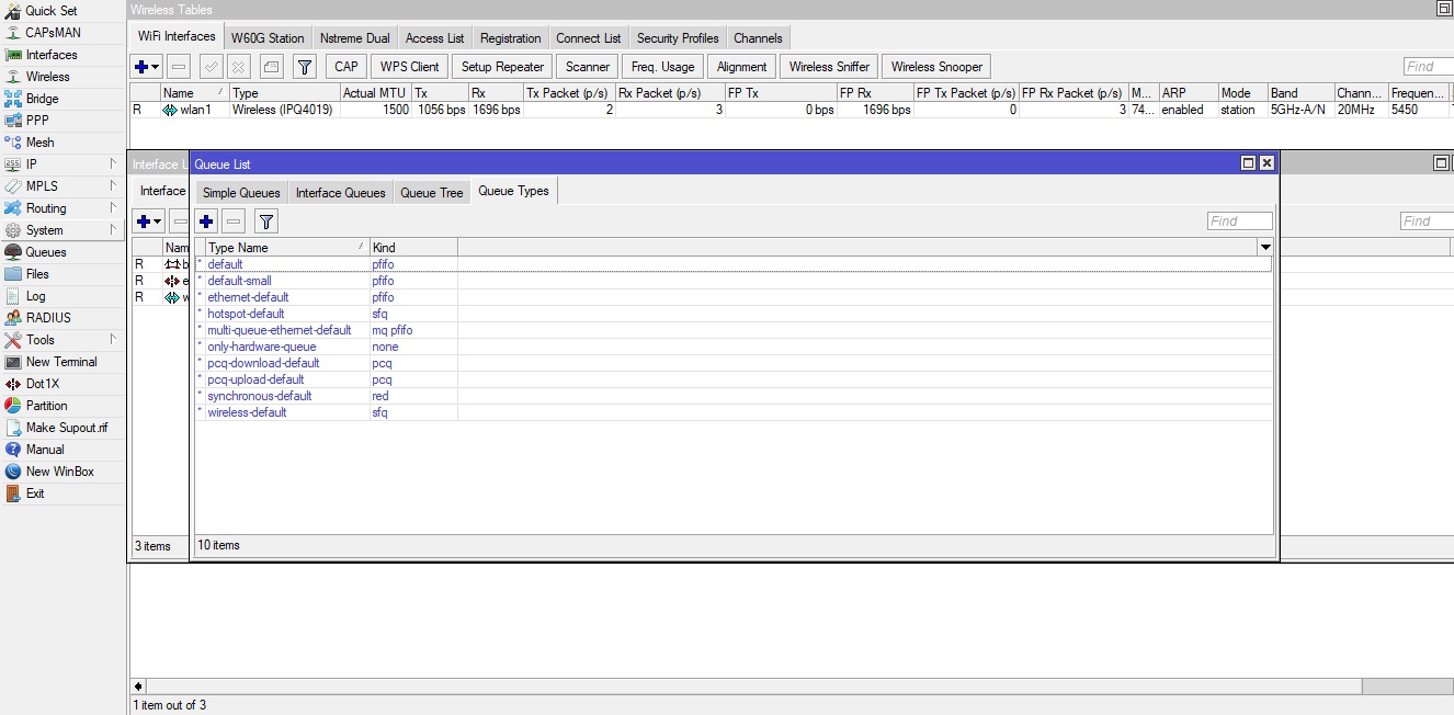

So, I did another speed test at 5:00 a.m. when supposedly many people are asleep.
I was able to get to 1.2 Mbps upload speed as seen in the images below. (well this is not close to 5Mbps, but it was a difference)
my tx/rx readings also changed slightly to 68-70/68-70
tx/rx ccq 23-41/75-90%
MAC Ping to the AP device averaged 13-25
I then ran a /tool speed-test on the winbox terminal and noticed a difference from before. the local and remote cpu load was below 100%
