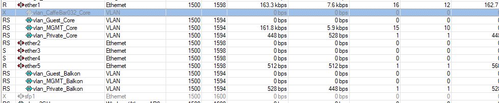

Yeah, so instead of doing something like this on a bridge between two ports:
You should try this since it might fix the problem:
