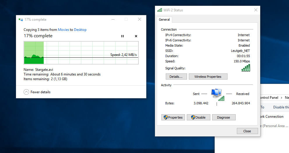

I have problem with very slow WiFi speed. I use Mikrotik WAP. I try lot of different settings but no change max speed is about 3MB/s from my NAS to device if I use wired connection I get over 100MB/s.
My reality :frowning: Before WAP I use cheap TP-Link for 10€ and I get much higher speed. Around 20-30MB/s or even more.

I’m using Mikrotik WAP, WAP AP is connected to HP switch and directly to that switch is also connected NAS. So WAP and NAS are directly connected to same switch.
My configuration

I use HP ProLiant Microserver Gen8 for NAS, and over wired connection I get around 110-120MB/s.

Yes I use WAP only as WiFi AP. I have upgraded both Firmware and Software,
I try your settings but no change, before WAP I use TP Link model TL-WR741ND (cheapest model) and I never have problems with speed. It has slower CPU speed and half the RAM of WAP so I really doubt that problem is in CPU.
